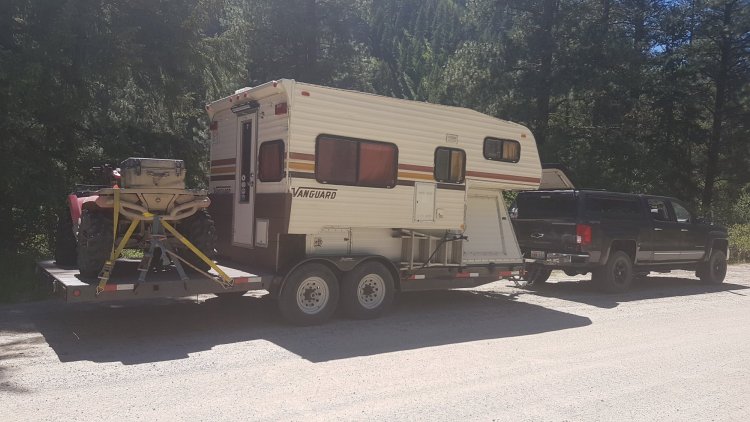

I changed out the stock ones that came with my truck after the first time I towed my 10k trailer they were not up to the challenge. Now mine is the max trailering max towing version so I got black ones which I am guessing are same as non z71 trucks. I could not at the time get a set of 5100's because I put on a 4" lift out of the gate and they were not available. So I bought a set of procomp's. I installed them and a huge improvement right away! Now with 60000 km on the truck I noticed one is leaking. So I felt that 52000 km was too short of a life for a performance set of shocks. So I am installing a set of 5100's this weekend because they make a set for the 4" lift now. I will report back how they run as towing season is here and I want to get away from all the smoke so I will be doing several trips south to the US and should get a good impression compared to the procomps.
I love your trailer, it's so cool. I had the thought of trying something similar to take my car to the racetrack but I ended up finding a used smaller toy hauler that fit my needs with less effort.

Red 5, Thanks. I built it in 06 and have been modding it ever since. It pulls well and carries 2 quads too. I haven't found a better solution for the money I got into this so I keep using it.
