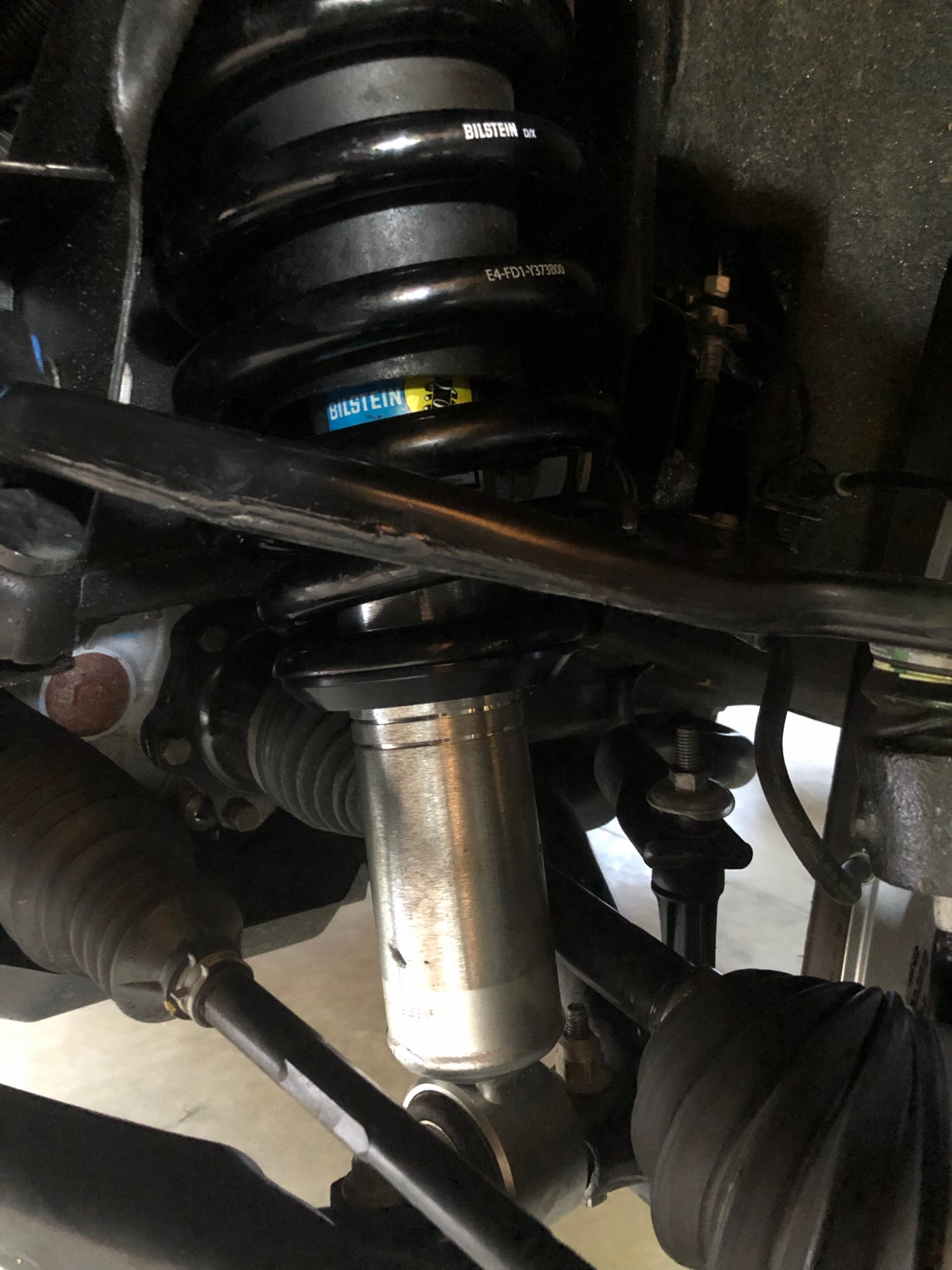

Also, measure from the middle of your wheel cap to the fender lip.  Then tire size won't skew readings in comparison to other trucks.
Thanks, will do. Starting to think my guy messed up... I should have measured before hand...

Try and search or maybe someone can chime in on stock fender height on Z71 suspension. I have Z60 suspension.
You would see the lower rings below the spring seat if set at max. Like others have said, always measure from flat surface and center of wheel. I hate to say it, but think you are at stock setting, maybe 2.
The 3" of rake is additional confirmation using rough #'s. If you bumped the back up by 3/4 , assuming 2 1/2 " stock rake , you would be right around  1 " of rake at max setting of +1.85 up front.  Hopefully you have some written documentation on what setting you requested.
Just to chime in, i measured my 2016 Z71 before bringing it in and i had almost exactly 2.5" of rake bone stock. Also, my shocks came set at the 1st (lowest) setting from the factory so i went ahead and moved the ring up to the highest rung before bringing it in. Didn't want to have to bring it back if they forgot to make the change! Curious what your install charge was? I was quoted $320 for install, front end alignment and tire rotation for good measure. Not cheap but the shop specializes in suspensions so I know it will be done right.

I posted this on the 6112 install thread, but will paste it here for others following this thread. I was desperate for measurements on 6112 prior to install. Hope it helps others..
Just returned from the shop that installed my 6112's up front and 5100's in rear.
I have the Z60 suspension and liked it. Truck is basically new and has 4k miles on it.
I was originally going to set at max setting (4) and install a 2" block in the back to achieve a level. I talked to the installer awhile before dropping it off and he asked what I was hoping to achieve. Basically told him this is part of a process to allow larger wheels and also not sacrifice ride quality, hopefully improve. He immediately asked how big of tire and I told him 275/60/20. I'm on stock 20" rims and 275/55/20 tires. He rec'd setting the front adjustables to third setting and leave the stock blocks in back. Told me I would look level and should have a rake of right around 1". After changing my mind multiple times, I went with the 3rd setting and eliminated swapping out the stock rear blocks.
First impression. I pulled up and saw my truck out front. It pretty much looked the same. Stock wheels and rims still on.  Only since I've been measuring and focused on wheels, tires, could I tell that there was a little more open space in the front wheel well. Most people would never notice. Truck appeared level.
I paid and jumped in the truck to head home. Immediately noticed my hood was a little higher, but nothing dramatic. I had about a 15 mile ride home and I took all the back roads back and they are in poor condition. I don't know if it was in my head, but they seemed a little smoother. I could feel the potholes, but only once and the suspension quickly recovered. I was moving at a good clip to test the changes and came around a corner where a car was turning and had to hit the brakes pretty hard. Immediately noticed brake drive was gone. I know the suspension is firmer, but only say that because I could hear a slight rattle near glove box, passenger seat. I never drive without tunes playing (had them off) and that might be some of it. Also had all the oem coils and struts in back, parts on passenger floor and my locking lug nut piece was still on a lanyard in the cup holder. I'll clean things up later, but suspect the passenger seat rattle might be due to stiffer ride, possibly loose stuff clanking. Time will tell.
Bottom line, I noticed two big changes. #1 The truck stays level in turns at speed. #2 Brake dive dramatically decreased. I felt like I could drive faster on rough roads and the truck was tracking straight after bumps.
Now to the measurements.
I dropped the Truck off and measured everything before the swap.
Front center point on wheel well was 36 3/4 stock, rear was 39 1/4 = 2 1/2" of rake
Bilstein 6112 with Bilstein 5100 in rear
Front center point on wheel well 38 1/4, rear unchanged at 39 1/4 = 1" rake.
So, I gained a hair over what I expected. It could settle a bit, we'll see. Bottom line right after install I gained 1 1/2" up front on 3rd setting.
I'm happy with the ride, but coming off new shocks and coils , it wasn't huge. It certainly didn't get rougher or unpleasant.
Next, I'll be looking hard at rims and tires to complete this project. Then, what I want the most is a tune. The owner and another mechanic both said they love my exhaust and wanted to know what model I had. I laughed and said it's a Borla Atak, really barks at start up when cold. They agreed and said they all really liked it except one guy. I wasn't sure what was so funny till they whispered and pointed to another mechanic. I looked and he had a Tshirt on with coffee stains up front. I guess he was standing next to it early am sipping coffee and it really startled him when it started and he split hot joe all over his white t-shirt.
I can also confirm that the Bilstein 6112's at the third setting will show 2 rings exposed below the spring cup.
Pretty happy so far and really looking forward to putting bigger tires and new rims on next. I'll have to drive it on the highway next to see what changed.

Looks like your guy messed up, you should be able to see rings underneath if it was at the top setting. That looks like the stock setting, which would explain the large amount of rake
He said he went with 3rd setting not the highest.
