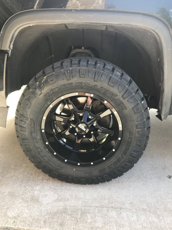

Thought I’d add to the discussion since this post helped me out quite a bit.  Yes the Ranchos suck, and the 5100s are night and day difference.  2017 GMC Sierra All Terrain X Package (Z71 w exhaust).

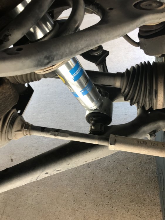

Put 5100 Bilstein’s in the back - easy enough, came from the Jeep world, this was no problem.
Used a local shop to install the front struts, set to the max setting with a 0.5” spacer to fit a wide tire.  I was going for the most tire I could fit with the least amount of lift without using one of those level kits, and said a little prayer.  325/60/18 (33.4”x12.8”) on 18x10 w -24 offset.  Yes I had to trim, metal and plastic, but I have no rub.  Truck is aligned, no stress on balljoints or cv’s. Tires sit about 1.5” out from flare, which is not too obtrusive and give it a good stance.
I’ll upgrade the UCA’s next.  But more wanted to see if the above could be done!  Appreciate the thread and posts (and arguments too)!

How do you figure? You added a .5" spacer,  max bilstein lift, a -24 offset wheel and a 325 heavy tire. Yeah, you have added some stress from stock... Have you said a prayer for your steering rack and wheel bearings?
Tyler
Tyler
True Tyler, any amount of lift will give stress. I was talking about the angle on the cv and balljoints that often you will see when people run those leveling kits (2-3”).  From this thread it’s been proven the strut lift mitigates that problem, and in my case the 0.5” doesn’t exacerbate it.
Does a 7” lift to fit 35’s come with a steering rack and wheel bearings?

How do you like the ridge grapplers? I was looking at them for mine.
Just drove down to the Gulf of Mexico from Dallas on them.  Very low road noise, nice balance, so far can’t complain.  Have done very well in sand.  I did not get a lot of miles out of the stock Goodyears that came in the truck (about 20k before they started cupping).  I’ve run (on Jeeps) Goodyear MTRs, Yokohama MTs, Mickey Thompson MTs, Interco SS and Nitto Trail Grapplers in the past.  So far these, as popular as they are, seem to have the best of both worlds (road and play), and they are lower cost from Toyos which seem to be the only ones with a similar RT style.  If they get 45k miles I’ll be happy!
which struts do you guys recommend? 5100's or 6112's? I drive 85% highway/10% city and 5% off-road if that. I commute 80 miles a day and I'm looking for something that'll be comfortable on the freeway, hold up better than the ranchos, and be decent on washboard roads. Don't know if the 6112's are worth it for me with such little off-road?

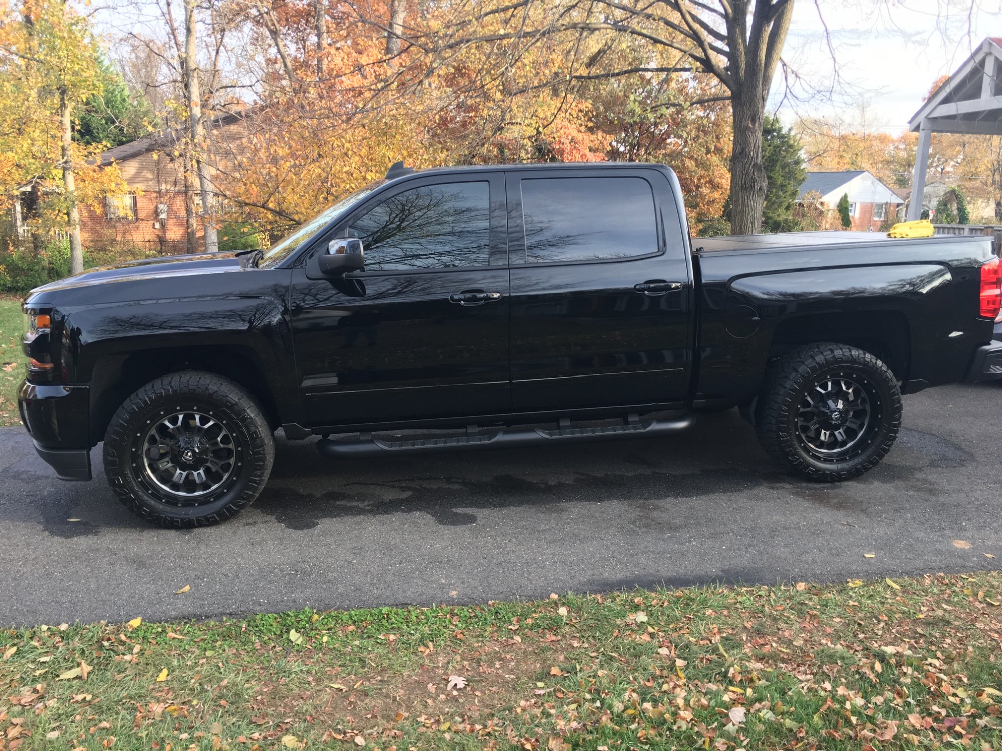

Original owner 2017 Silverado Z51 that has a RC Aluminum leveling kit. 2" part number 1308 on a set of 295/55/20 tires.
I am thinking about doing the Bilstein 5100 shocks and struts. I don't dislike the Z51 setup, but I am sure it can be improved upon. Truck has 36K on it.
I like how the truck currently sits and don't want to mess with this.
Far from an expert on shocks and suspensions so my question is - can I leave my 2" RC leveling blocks and just install the 5100's at "stock" height and they should be the same as my current set up?
Is that correct / is it possible?
Obligatory pic of my truck. sorry not the best angles but all I had on hand.
Edited by DaddyHasABigTruck

That’s exactly what I did on mine.  Truck rides great.
I went with the 6112’s because it is the strut/spring combo the truck should have from the factory, just replacing stock strut and keeping factory springs will only change the ride 50%. Might as well do it once and be done! I drive the same style as you and am so glad I waited for the 6112’s, installed myself as it is a piece of cake!

I removed my spacers when I installed the 6112’s, better geometry taking them out when running factory control arms. Put the 6112’s or 5100’s on the top ring and your at the same height up front with a better ride!

    • Is it an optical illusion in the pic or is the truck really squatting that much horribly?
