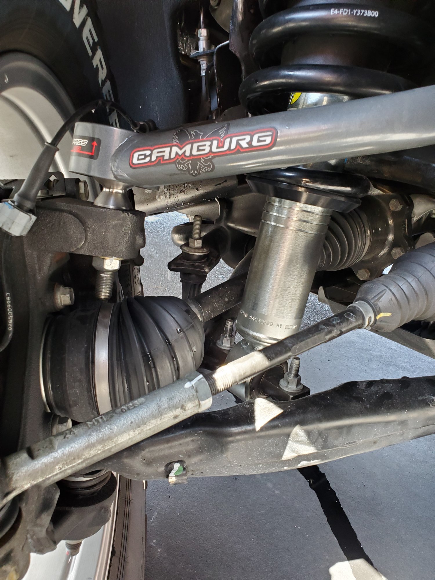

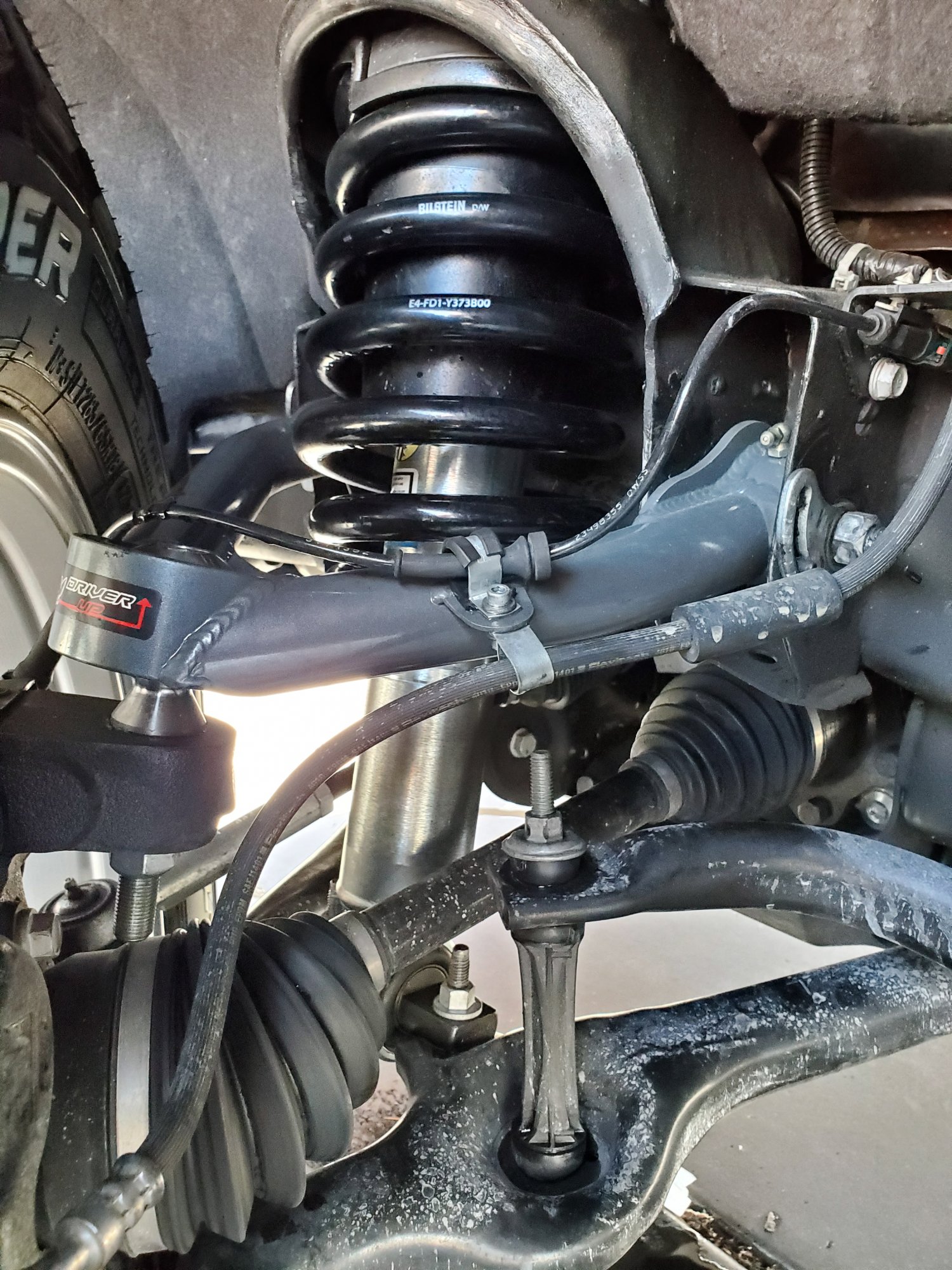

Stock wheels? What's the backspacing?
Double check before putting on those camburg uca. Think the minimal amount is around 5" or so. Maybe little less is ok. Believe camburg recommends 0 offset wheels. Which is exactly what I have. Heck my stock uca had a slight rub from my stock 20's. I like the slightly aggressive look with the 0 offset as well. Pokes out about an 1- 1.5 with the cooper at3 xlt 285/65 18.
Wheels are black rhino Mozambique.
Good luck.
Another thing. I have the 6112 at max and also 1" shackle lift on the rear and they look same height. Maybe that's just cause my driveway is sloped? I'll check on flat ground today. Thought it should have at least 1" rake. No worries as I rarely tow or haul around anything atm. If I do more towing I might add bags or active suspension.
I know pics. I'll try to pop some up later.
I got the call this am that mine will be pushed back till next Friday. I'm close with the owner and told him that if shit came up, NBD. Not happy but what can I do? I have too much on my plate as it is and don't feel like being that guy.
I have the stock All Terrain 20's and they should clear the UCA without issue. I read that note on their website and went out and looked before ordering.
