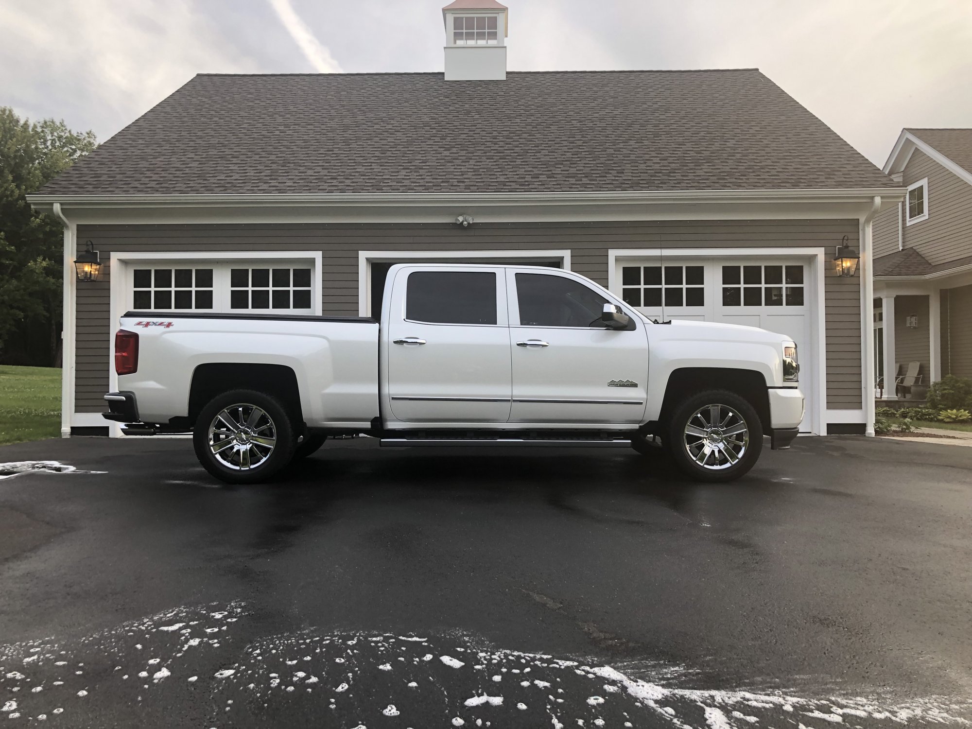

I posted before and after pics of bilstein 6112 on #3 setting in the Bilstein 6112 Installed thread for those trying to get visual.
I posted before and after pics of bilstein 6112 on #3 setting in the Bilstein 6112 Installed thread for those trying to get visual.   IMG_0782.thumb.jpeg.ee7e18208e2f6bdac0f7c73e33acf32c.jpeg
Did you add an inch in the rear as well or stock block?
Edit: never mind. Saw your post in the other thread. Looks good. I'm hoping that after I get the ring adjusted next week my 5100s match the slight rake you have in your after pics.

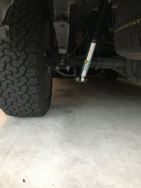

Is my brake cable routed incorrectly? Seems to be hanging down below the axle, and I don't recall how it was routed prior to the rear install.ba8e02794c53dfc1e70ce441a86a68cb.jpg
Sent from my SM-G973U using Tapatalk
You’re ok.  That’s what it should look like

Ok, so the first attempt did indeed only set the height at the second ring. Just moved it to top ring today. Fixed my problem.
First pic is the 5100s on ring #2 with 2" rear blocks. Second pic is ring #4 in front with same 2" block. aa32b140245cc1451e8e1e76d773853f.jpg13f22d01d7d280d1665d59360f25902a.jpg

Much better look IMO.  Nice job!
Looks great. Now you got that nose up. How do you like the ride?
I don't notice a difference in ride between ring 2 and 4. Both ride great. Worthwhile upgrade, very happy with them so far.
