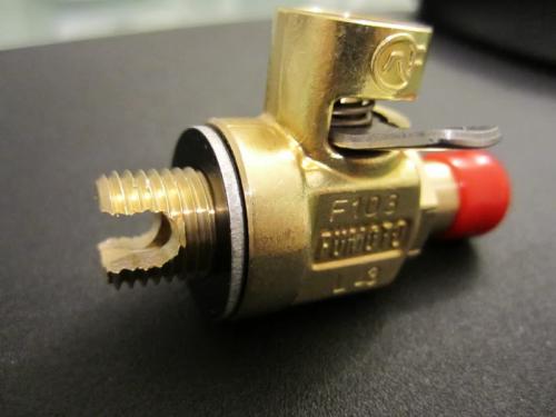

The only thing I read negative was the fumoto plug threads stick into the oil pan 1/2" thus potentially leaving heavy particles or build up in the bottom of the oil pan. Anyone with one of these plugs ever have an issue? There is no provision for a magnet either. I am looking to buy a fumoto plug but not sure I like the idea of the oil not completely draining from the oil pan.

Looking at the Fumoto valve, looks like to me it's about flush with inside oil pan, eh?
I could see that being an issue but it probably varies between engine manufactures. The factory drain plug on my Sierra was pretty long and the threads into the oil pan were pretty deep. The Fumoto valve is a little shorter. On top of all this our engines have the oil drain plug slopped towards one side which should ensure all oil is getting to the drain hole. Combine this with Fumoto thread length being a little shorter then the depth of threads in the drain hole, all the oil that can get out should get out.
Its not like the pan is a calm environment that allows all this "goop" to collect if quality oil is used and the vehicle is driven. Our oil is a lot different from the days when sludge was a common issue.
I replaced the pan gasket on my Cummins at 250k with all those miles on extended drains and a fumoto that left at least a half inch of oil in the pan (you need to understand the drain plug and bung in the Cummins). That pan didn't even have a film in it.
I seen where some one cut a slit on the treads to allow for the oil to drian all the way out
or park the truck on a block to allow the oil to lean to the side where fumoto valve is,
