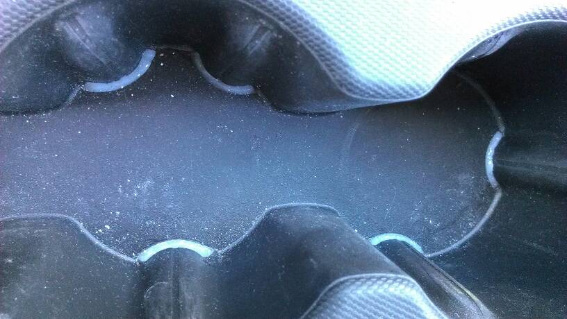

be aware: cupholder design flaw
d3m0n
When asked about the slots in the cup holders and if they could be fixed with silicone, GM said "We're unable to provide any advice that would modify your vehicle from its original factory specifications. However, we've reached out to our internal resources and have been told the cup holder slots were just the design chosen for the vehicle."

All you gotta do is try it man. I will say from my original post that I had to do some modifications. There was a leak when I filled the cup holders with water after siliconing the first time. Silicone doesn't hold the best on the plastic being siliconed to. It can peel right off too easily. My fix was to just put more silicone on it. Not on the bottom but the sides. You can't put more on the bottom as the two prongs need to be able to snap into the base. Put lots on the sides. You can put more on the bottom as long as it is not too thick. This will help the silicone stick overall. That is what you are looking for. So you have to change it every year or so. My old 99 had the removable rubber. This is a pain and should be fixed.

How is this ok to have a cup holder that vomits all over the seat in an accident? Do they really think everyones gonna be perfect and super careful with their cup holders and never have an accidental spill or a leaky cup or.. use the cup holder to carry raw liquid?

Manufacturing the cup holder assembly as they did may have saved $0.025 per unit as compared to sealing it. Multiply $0.025 x all K2 trucks sold over a typical 7 year model cycle, and you've got yourself a sizable sum of money.

I'm thinking a rubber patch kit might work. Rough up the bonding surface, trim the patch to match (both inside and underside) and use the rubber cement to make the bond. If the patch isn't pliable enough use a trimmed piece of bike tube. just thinking out loud.
Just used clear silicon on the under side... Did this a year ago. There are other threads showing it...
