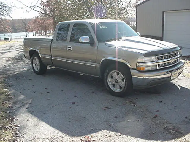

I have pewter 2001 Silverado 1500 ext cab that I bought in 2006 with 97,000 miles.. now hs approximately 170,000 on the odometer.. has been an awesome truck... always been pro active to replace items before they broke... love my 01 as it runs and looks better than it did when I bought it!!! have an 01 Tahoe also...
