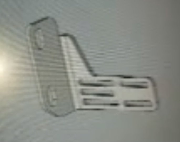

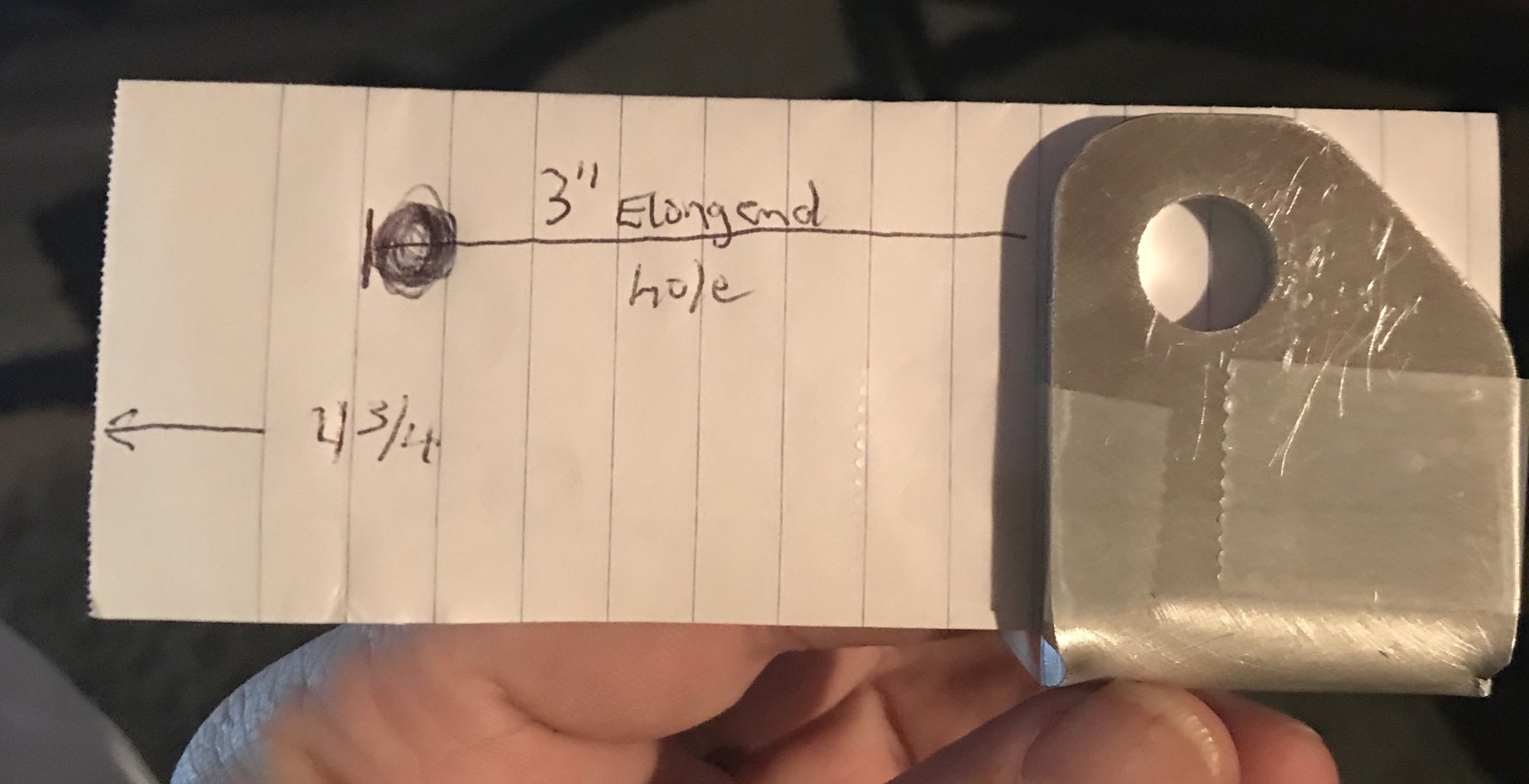

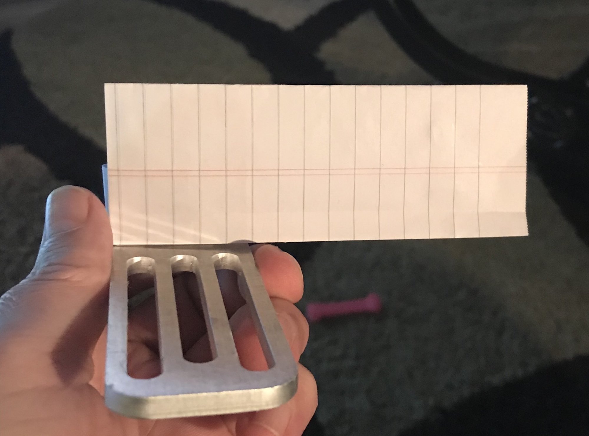

The RXP is a great setup too and not that they are into doing something for nothing, I’ll share this...I want to mount my can off the drivers side fender, under the braces. Couldn’t do it to my standards, I could have used the bracket that came with the kit but wanted something more. I contacted RXP and told them what I wanted and they told me to send them some information and they’d see if they could help me out. I sent them (don’t laugh) pictures of the “stock” bracket with some desired modifications. The first pic is where I want to mount it, the second and third are my makeshift “template” and the final pic is what they made for me...didn’t even charge me shipping! That is customer service at its best. RXP is my choice but UPR is excellent too with good customer service...can’t speak about Elite. The RXP came with OEM fittings and really sweet check valves. For the people who think this is gonna create a vacuum issue BASED ON HOW MY WRITTING IS TAKEN, PLEASE UNDERSTAND THAT THERE IS NO VACUUM ISSUES...to say it’s gonna make the oil cap harder to remove is completely off base. These are pretty simple systems, no matter what brand you use. About the only way to mess it up it to install the check valves in backwards...so the talk about vacuum issues posted below (a few posts after this one) and is miss-quoting (asnin changing words) is just wrong.

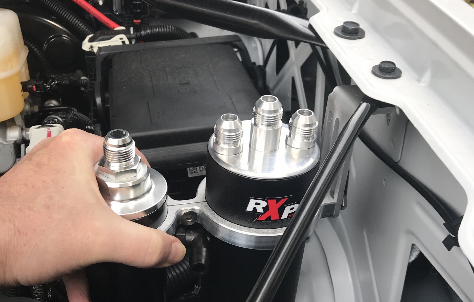

Okay, on my RXP (and I’m not saying it’s the best or that you have to have it or that they provide absolute protection from anything) dual can set up its hooked up like this. The dual port can (bigger one in picture) has a dirty side line in (center port on can) then two clean out ports, one goes to the clean in barb on the intake manifold, the other to the air plenum (you can tap and install a barb just in front of the throttle body or go to the intake port on the plenum on the passenger side) and that accounts for all three ports in the can...center for dirty in and the two outside ports are clean out. Now the small can, it takes the place of the older CSS that used to fit into the stock oil cap, actually replaced the stock oil cap. It then ran to the air plenum intake port on the drivers side. With the small can you tap off the valve cover bridge line, into the top of the small can, the side port on the small can is then routed to the same port the older CSS did on the air plenum port on the drivers side.

Thanks, as far as I know RXP is the only one CURRENTLY using this setup. Their customer service is great, see my post above, they made me a custom bracket!

Where exactly are you putting your can (pictures please) where it isn’t getting “extremely hot”? The common brake booster mounting place is much hotter than the fender, just behind the radiator, although there is some air flow, is much hotter than the fender. The spare battery tray/fender mount (and make sure you look at where the ACTUAL can is located, not the mounting bracket) provides ample room for ease of emptying and doesn’t get so hot you can’t touch it...the valve covers get hotter. This mounting area also makes it very easy to get to the oil dipstick. Anyone who knows how the catch can/PCV system works will also know the oil cap isn’t gonna be hard to remove ?. There is no way without pictures you can say it’s installed wrong, that’s an assumption based on your interpretation of written words. I may not have explained it correctly to your understanding but you should have just asked for pictures or clarification before you assume it’s installed wrong, which by the way would have most certainly kicked a CEL if your assessment was right, it hasn’t. No seals have been “sucked inside out”  and on that note, I bid you farewell. Show me your setup WITH pictures please so I will know the optimal spot to install a catch can.

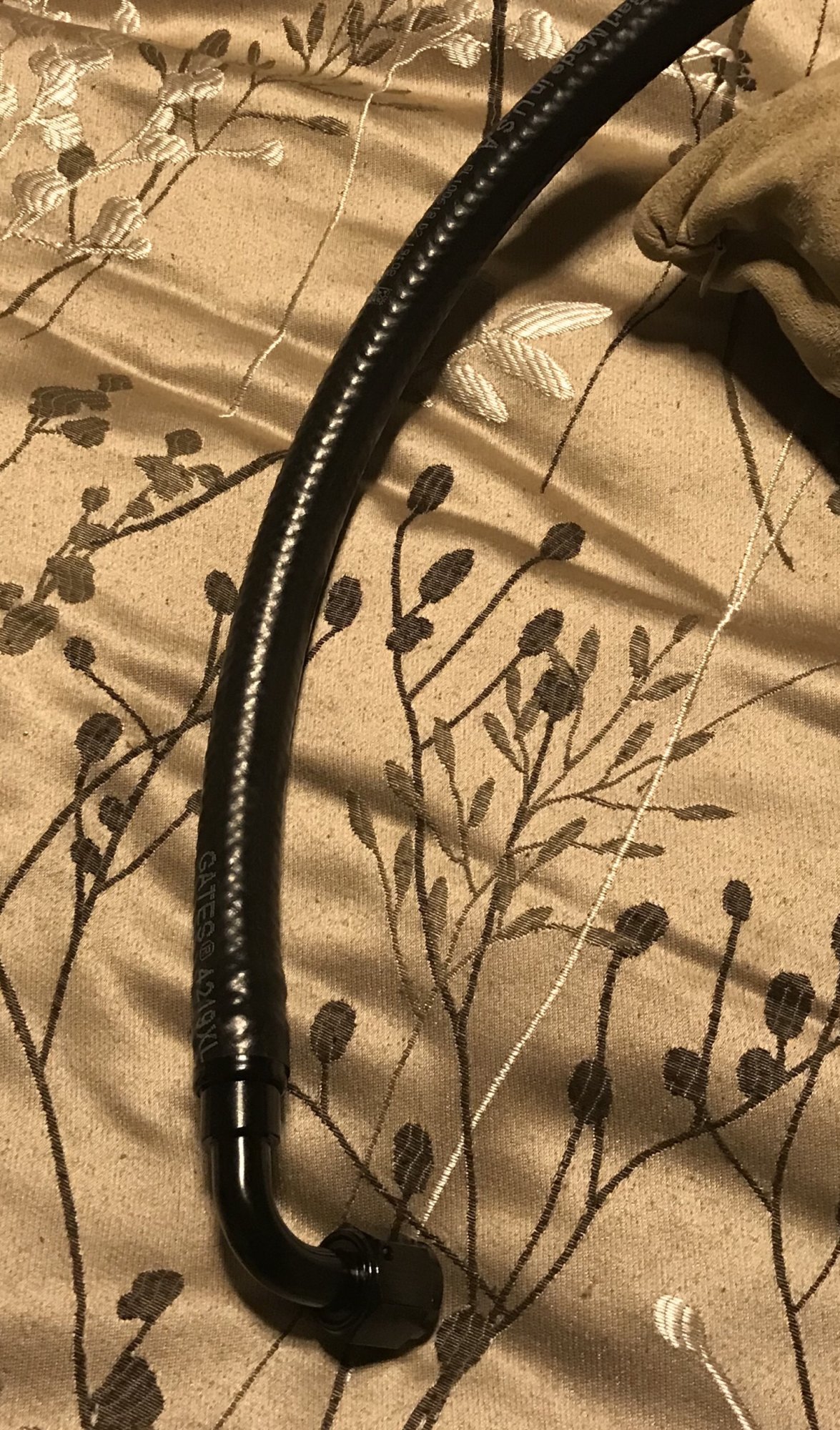

So you had to cut Joe's nice bridge line for his CSS sytem to put in a T to bring to the small RXP can?
4 hours ago, 3tspapat said:
That RXP can is HUGE! is it really HUGE or just looks like it?

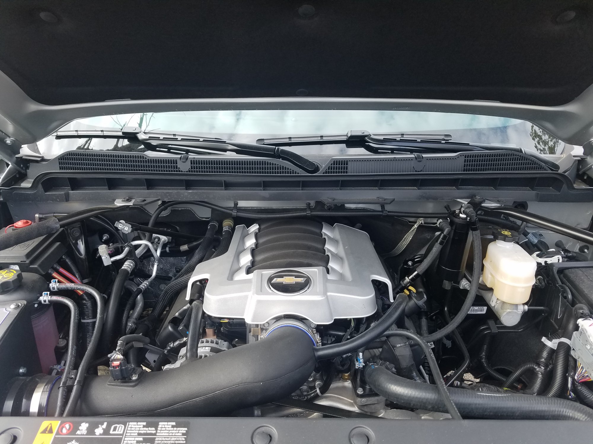

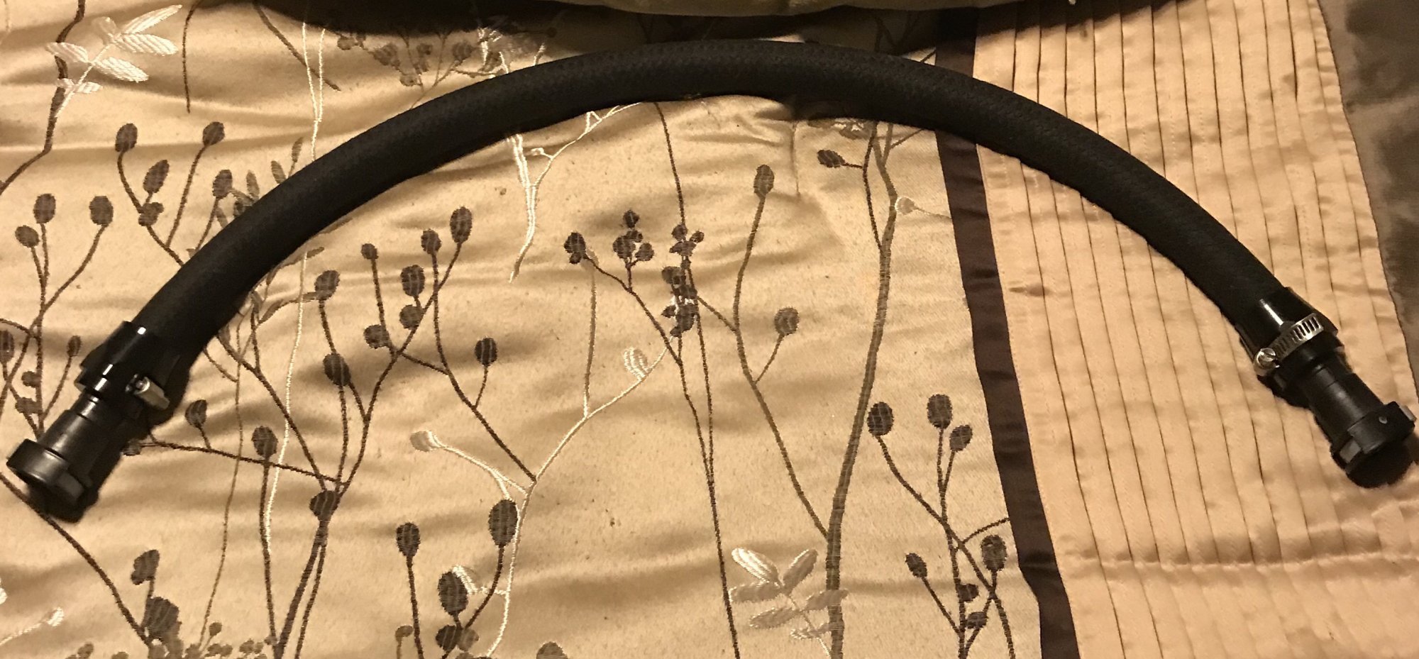

No I did not cut his hose YET. I want to make sure this is the setup I’m gonna stay with. I removed it all to wait on my new bracket. I am still having knee post surgery problems. I drive the Accord right now. Here is a pic of Joe’s nice hose still intact! The smaller hose is the cut one. But if I stick with this, I will cut and use his line, it’s a better looking line to me. I also got some AN-10 hose looms to make it all look clean when I get done.
