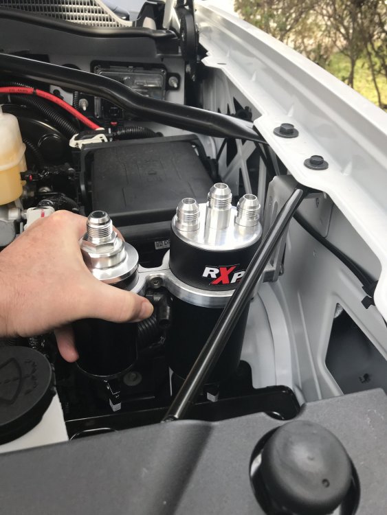

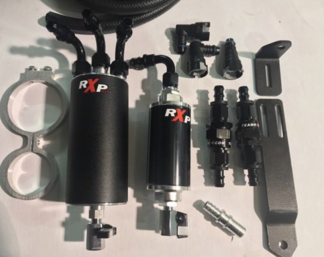

I like the sound of a dual can instead of a clean side separator like elite's but there is only one port on the clean side so I'm confused what do you do with the other side? clean side pcv > catch can> intake tube leaves the other clean side just connected directly to the intake?
Okay, on my RXP (and I’m not saying it’s the best or that you have to have it or that they provide absolute protection from anything) dual can set up its hooked up like this. The dual port can (bigger one in picture) has a dirty side line in (center port on can) then two clean out ports, one goes to the clean in barb on the intake manifold, the other to the air plenum (you can tap and install a barb just in front of the throttle body or go to the intake port on the plenum on the passenger side) and that accounts for all three ports in the can...center for dirty in and the two outside ports are clean out. Now the small can, it takes the place of the older CSS that used to fit into the stock oil cap, actually replaced the stock oil cap. It then ran to the air plenum intake port on the drivers side. With the small can you tap off the valve cover bridge line, into the top of the small can, the side port on the small can is then routed to the same port the older CSS did on the air plenum port on the drivers side.
