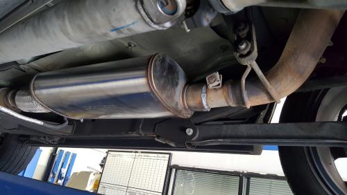

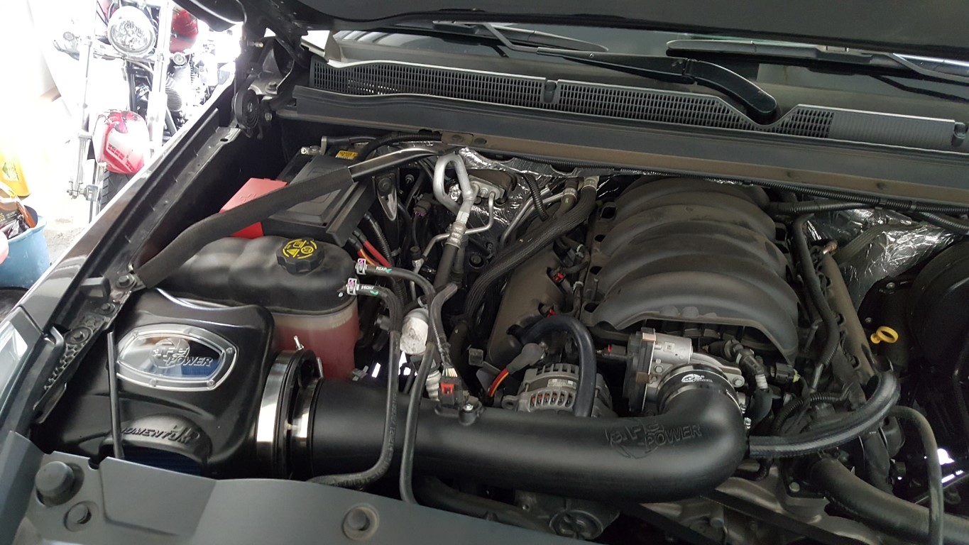

I went with a Magnaflow 12909 muffler only and paired it with AFE Momentum CAI for my 15' 6.2 suv Denali. Left the flap and resonator in place. Removing the resonator may create drone. The sound is awesome and very happy with the setup. I am going to delete the flap as it is 3" diameter vs 3.5" on all the OEM exhaust piping.
I was looking at Corsa and Borla but for the SUV they are 3" tubing (Borla has 3" to 2.5" on muffler) vs 3.5" factory. Doesn't make sense to go with a smaller 3" tubing (SUV). I'll stick with the bigger tubing and the 12909 is 3.5" .
$140 for the muffler fron Norcal SS and 120 installed at the local muffler shop.
As for the GM Borla Trucks & SUV's, the twin 2.25" outlets will preform just fine, think velocity!
GM's Borla with bypass tube & 3" flapper valve and twin 2.25's will out flow your system, I have no drone on my truck with GM Borla. Additionally you didn't mention your welds will rust, factory exhaust is aluminized steel to reduce rusting/corrosion , muffler shop just used standard mild steel on your welds its going to rust long before your factory exhaust would have.
until you remove the 3" flapper there was no point other than sound.
