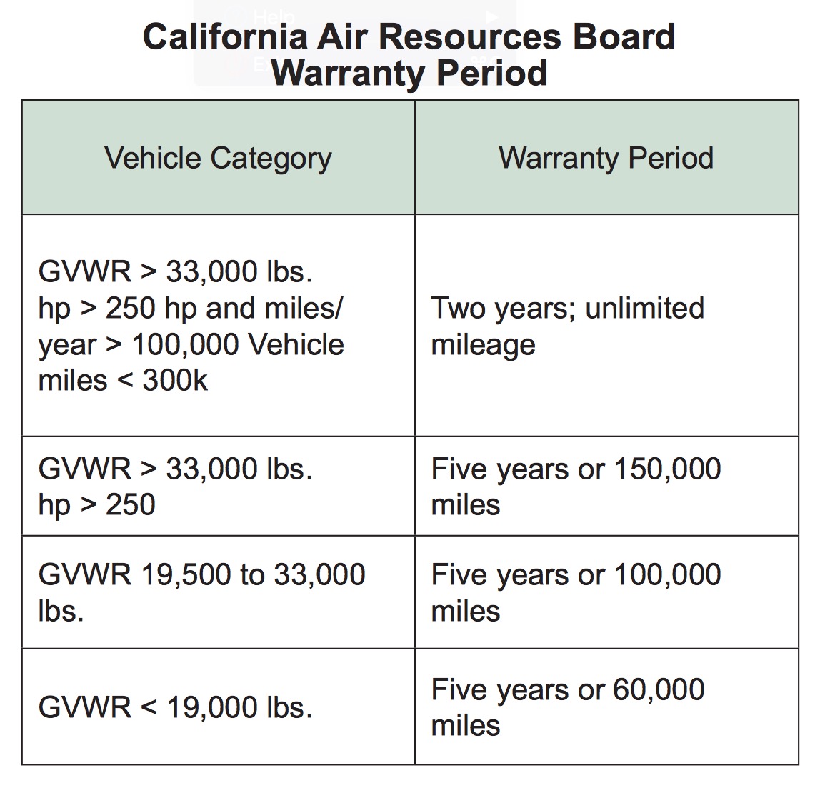

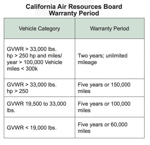

I haven't kept up on it myself, but I was under the impression that the emissions stuff does have the 8 yr / 80,000 mile warranty as mandated by the EPA that is separate from the drivetrain or vehicle warranties. Did a little checking, though not a thoroughly detailed check, and the California Air Resources Board, which the defecto toughest standards on this kind of thing, show only a 5 yr, 60,000 mile warranty requirement for DPF's on a vehicles under 19,000 lb. So if that is the case, then doubtful that there is a longer warranty requirement from the EPA on the DPF's.
