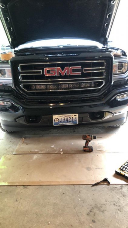

Were you able to remove the grill without removing the trim underneath?

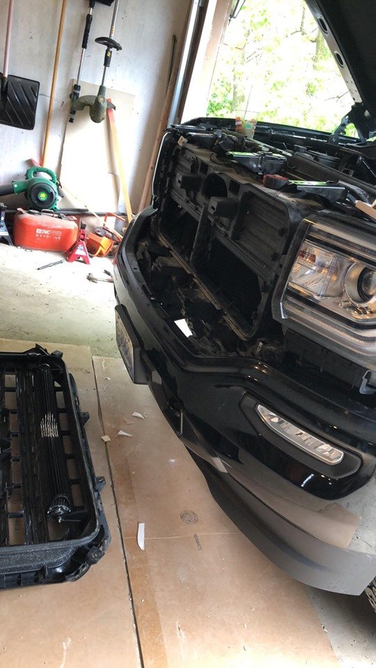

He did this on his Silverado, which has a different front end than our Sierra's. You have to remove the trim piece between the bumper and grille in order to remove the bottom grille bolts. I just did this about a month ago, no way around it. There's a youtube video of a guy who was removing the grille and bumper on a 2016+ Sierra, search for it if you need help. He does a good job of explaining and showing how to remove that trim piece (it's a pain the first time you do it, but once you know how it's a breeze if you have to do it again).

Thanks! I have watched the YouTube video before and am not too excited about removing the trim piece. It looks flimsy and brittle but I'm sure it's probably tougher than it looks. I have new emblems to install and think I'm going to go ahead and buy a light bar and install while I have it apart.
Yeah if you're going to have all that apart for one thing, might as well install something else you want while you're in there. It's not a hard job to do, just tedious. Gotta remove the fan shield on top of your engine bay to start (lots of clips), then remove part of your wheel well trim (bolt and clip), then remove the trim piece (multiple tab points), then you can finally remove the grille bolts and take the grille off. Might as well clean off your radiator too while you have access.
As far as that trim piece it's got flex, but definitely not brittle or cheap feeling. Obviously you can't go nuts and yank the crap out of it, but don't be afraid to give it some muscle on the parts of the trim that are directly under the headlights. Once you reach the corner of the headlight closest to the grille, that's when you go under the truck to release the tabs from behind the trim piece. It's tight in there so you'll need a long flat head screwdriver to reach a few of the tabs. You can't muscle the tabs loose though, if you don't release them from behind you will break the tabs and have to buy a new trim piece. Just take your time and it'll go smoothly, good luck!
