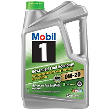

Not 100% sure but I belive the Mobil 1 Dexos 0W20 is full synthetic. Was looking at a jug on the shelf this evening.
You mean this jug...the one that clearly reads "advanced full synthetic"?
It was in a different jug with a diferent label for Canada. It said 'synthetic, but can't recall if it said full synthetic. I was a bit distracted by the price, which was 62.00 Cdn.
