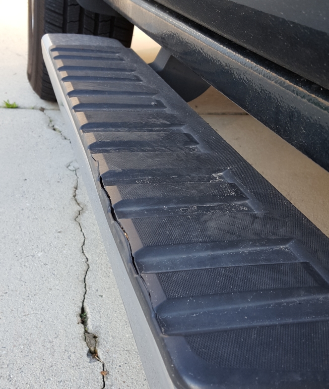

I was pumping gas today and realized that the plastic pad on the side step had cracked. I did some research and found the part number is 84106539. Has anyone replaced these? If so, how easy is the job? It looks like they may just pop off and back on but I can't find any definitive answer about that online.
Yep, pop off and pop on. I've put tons of them on.
You can get a flat head screwdriver in there and pry upward to get your fingers under and then start tugging!
How'd you crack those? They seem pretty solid, even for a plastic piece. I am pretty sure I recall reading somewhere they they do pop off. You may destroy them further in doing so, which I'm sure you don't care. And I think the new pads just snap on.
TGG my driver's pad cracked as well at about 15K miles. Dealer replaced under warranty when the truck was in to replace torque converter. Pad is simple to replace.
My truck won't fit in my garage so it sits outside all the time in South Carolina. So between the sun beating down on it and my 200 lb frame stepping on it, I guess it was too much after 3 years.
Mine is cracked in the exact same spot....not as bad as that yet, but I'll eventually replace it. I consider it to be a wear item.
Looks like you took a picture of mine.
x2. I'll eventually replace it when it gets a little worse.
My oem boards on my '09 had 6 years of "heavy" use and the truck was never kept undercover. The plastic was (and still is) in good condition. My new truck has Aeries boards and the passenger side plastic was lifting. Dealer replaced for free. I don't believe this cracking should be accepted as normal wear and tear.
No plastic lasts under the extremes of heat, cold, light and stress. Metals have a crystalline lattice, polymewric bonds break down under light and heat, and fracture when cold.
Armor-All might shine it and restore the color somewhat with a lot of scrubbing but can't filter out the light which depolyimerizes plastic turning it white and brittle. Window shutters molded in colors turn white with age, but paint protects them, the paint lasting longer than the original painted surface. Found one product that works great on the crapo GM black plastic. Simple wipe on and makes it look like new. Turned the 5 year old plastic sails on my Avalanche to a new l;ook which I'm sure got me extrra bucks in the trade.
Wal Mart and others carry Bondo Restore Black usually found in the body repair materials section. One simple wipe on application, flattens out with no applicator marks and it looks like new for up to a year. I use it on the bumper pads, and treadles or anything else that is black plastic with potential for fading. Could be some type of paint for all I know - but it works great and can take washings and wear. Worth a try considering the dramatic look you get on aged plastic, ease of application and its opaque barrier protects the underlying plastic
Mine broke in the same spot and started hanging, after a failed glued attempt I just pulled the broken piece off. it's hardly noticeable.
