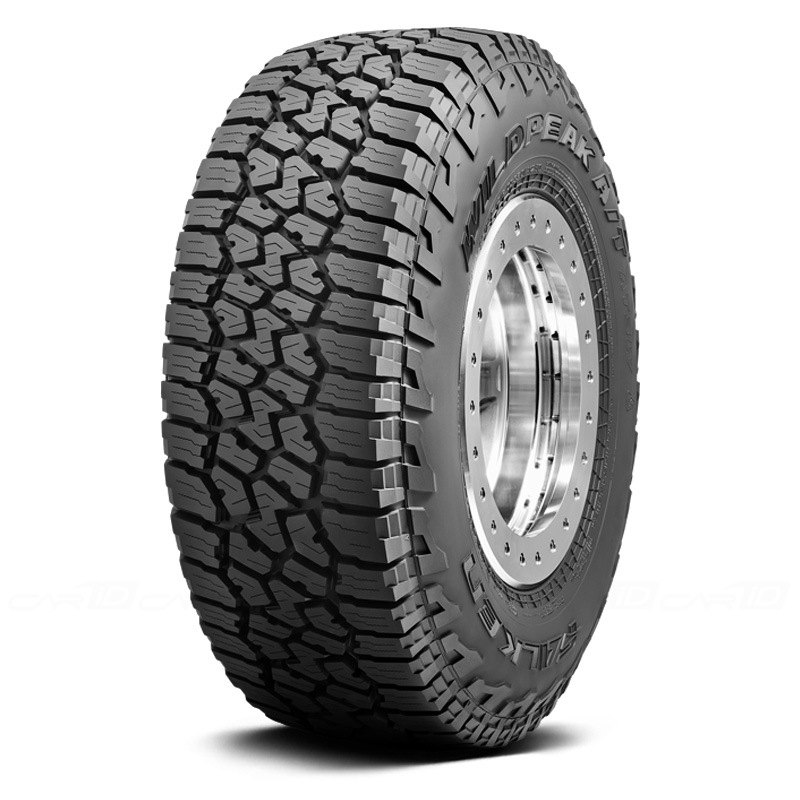

I'm replacing tires this week on my Sierra. Going with Falken Wildpeak AT3W in P275/60R20 (vs factory P275/55R20). Will post an initial review later next week.
I put some 275/55/20 Cooper Discover At3 om mine and like them. I've had them on for about 4-5 months and zero complaints. I paid around $850 for all 4 mounted and balanced. We'll see how they do in the Wyoming winter in a couple months.
I second the Falken Wildpeak AT3. Smooth ride, fairly quiet for a all Terrain this aggressive.

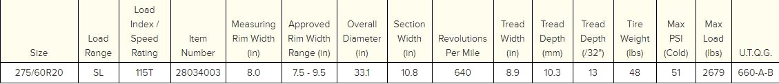

I went with a P275/60/20 that measures 33.1" tall mainly to give the 20" wheel more rubber to ride on for a better ride. Only thing I would change if I did it all over is go wider like a 285 or 295. However I don't think those sizes are available in a P metric.
