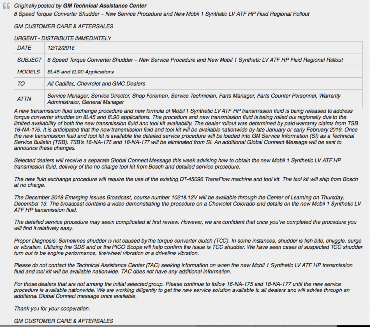

On 10/4/2018 at 3:52 PM, pewterliftedz said:
Does anyone have the TSB number?  I'm getting a shutter around the 50 mph mark, plus or minus 10 mph.
16-NA-175  they updated the service bulletin in October. It says they will come out with a fix first quarter 2019. They flushed my transmission and replaced the fluid 12/2018. Fixed my shudder.
Same here, reprogrammed the tcm also

There is a new TSB out that just came out here in January 2019.  GM got with Mobil and they developed a new transmission fluid that is supposed to solve this issue.  I'm sure it will take a little time to get the fluid to all the dealerships.  But looks like a complete change out of fluid with the new fluid is the fix for the shudder.  I would say contact your local dealer for more information.
Had this issue.  Took to dealer on Monday and they replaced the transmission fluid per TSB.  Only 3 days but the problem is not present anymore.
Same with me
