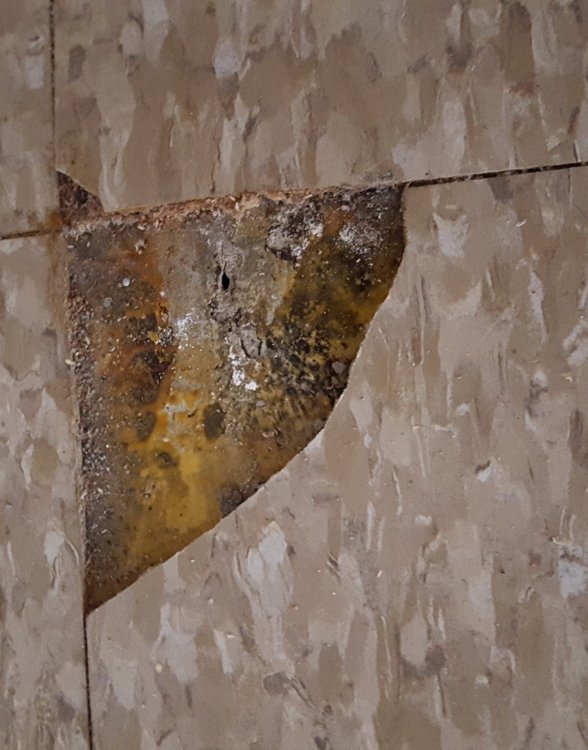

Hey guys,
Any one here know what this funky stuff is under my basement tiles?  Been in this house for about 6 months and the basement on random days has a really funky smell.  Everyone that I've had come down there and ask their opinion all agreed upon a cat pee smell (previous owner did have a cat).  I soaked the floor with a gallon concentrate of the cat pee remover stuff from Pet Smart.  That didn't seem to do anything.  I bought a gallon of this odor ban stuff from Home Depot and mixed it real strong, did the floor three times.  No luck.
I'm wondering if its a mold or something... I tore a piece of tie back.  I think I'm gonna get ready soon to tackle this project of tearing it all up and maybe rent a floor scrubber from Home Depot and get a super aggressive pad and some type of strong cleaner and go to town.  I just hope I'm not getting into a major health hazard (mold.. etc...?)
Thoughts what's going on here?
Any idea how old the flooring is? Question is whether it's of the age to potentially contain asbestos. If so, you'll need to bring in a profe$$ional to remove, and it's definitely hazardous to your health.
No idea how old the flooring is.  When the had the home inspection done, the inspector was leaning more towards no, however he suggested an asbestos test to be absolutely certain.

Maybe mold, urine, or tile glue is what you are seeing.

house was built in the 1950s.  Don't know much else.  I am going to get the tiles tested for asbestos.
Let's say that is mold, wouldn't that be dangerous for me to cleanup as well? Doesn't it like get in the air something?
Its hard to say from that photo, but you have some combination of dirt and grime and tile adhesive first of all. I don't think I see mold. but who knows.
What is the sub-floor? are these tiles on concrete? If so I would not hesitate to scrap everything up. Pending, of course, the asbestos problem. You could remove asbestos yourself and put it into garbage bags and haul it to an appropriate disposal center, but make sure you have breathing protection and ventilate the house. Or you can pay someone to do it for you, probly much faster.
Anyway, basements have all kinds of smells. Outside of the possible cat urine, are you confident you don't have any other water leaks anywhere? musty water does not smell good. I previously gutted a basement where someone had "improved it" without any water protection, leading to a lot of rotten wood (studs and plywood sheathing). I had to scrub the place down with a bleach solution, but after that, the musty smell was gone.

It's just cement underneath the tiles, no sub floor.  I don't believe there are water leaks anywhere.  I have walked around several times looking at the floor above and the wood appears normal.  I notice the stench in two corners of the basement.  One corner is where the litter boxes were. My  basement has a wall that runs about 60% of the way across about a quarter of the basement, soon as you get onto the other side, it just smells like a normal basement, so I have isolated it to the tiled area from this "scientific experiment" lol.

The tiles aren't too thick. Maybe like 1/8 of an inch? I'd have to measure.  Definitely waaaay less than a quarter of an inch that's for sure!
Yeah, those look like the old asphalt floor tiles that were very common around the 50s. I helped my dad remove those in the kitchen of the house I grew up in. If there were cats leaving bodily fluids in that room, it is likely that some of it ran down the cracks and is still underneath a lot of the tiles. I predict that once you remove that flooring and scrub the concrete, your smell will be gone.

Asbestos is so over rated. If it was, you just need to not cut or sand the tiles. Get a good face mask and remove them yourself. If you get a real test done your screwed if you ever want to sell the house and those are not.  I have 11 rental homes. At least 4 of them asbestos siding. It another government freak out.
Its simple a mess of dirt, grim and adhesive. Clean it up and move on.

Buy a big flat scraper, scrape floor clean. Don't rip the tiles any more than you have to. Contain everything in plastic bags and haul to a place that will accept it. Tell them it may be asbestos but you don't know.
