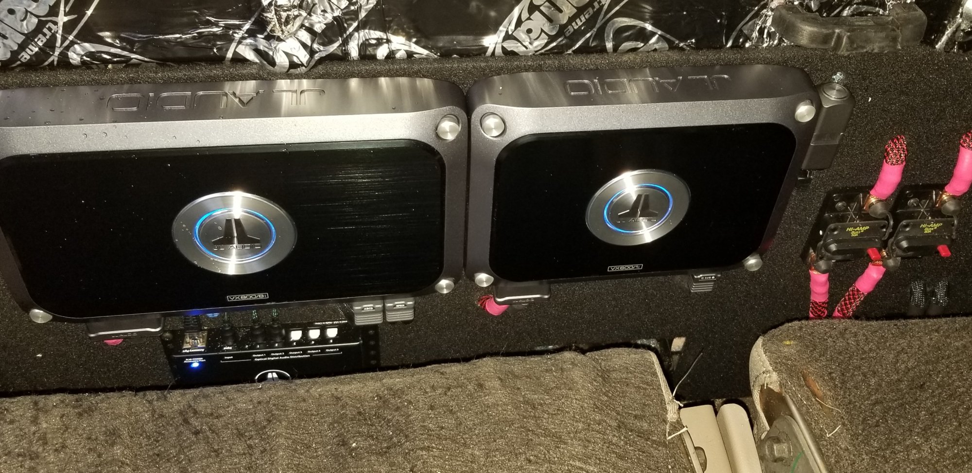

I just did a fill system in my crew cab.
I have
            focal yellow 3 way in front doors and dash
            focal yellow 2 way in rear doors
            JL audio 12tw3 shallow sub under rear seat
           JL audio 800/8i 8 channel vxi for mid/high
           JL audio 600/1i 1 channel vxi for the sub
           JL audio hub for tuning/connecting them
           Dual batteries-second in factory location
           Tons of dynamat-WORLDS OF DIFFERENCE
           using all optical cables--  no rca wires.
I have about $6k in the whole system. And it wouldnt be possible or sensible for me to do it unless i had the t harness.

How did you mount the mounting board, and where did the factory amp end up?
Did you use all 8 channels, bi-amp, or bridge some? I assume there are 5+1 from Bose system (Front, Rear, Center, & Sub)?
Thanks for any insight. I have the Focal 2 way in front, Focal coax in rear, and a focal 3krx3 mid-range 3" driver pair for the dash/center. I am adding the NAV-TV and amp next, but only have a JL HD900/5. So I am trying to figure out how many more channels I might need before I rip into it.
I removed the bose amp to just under the rear seat where the jack used to be. Then i removed the studs that the Bose amp was mounted to. I then used riv nuts and installed them in the brace close to the top of my mounting plate. That way there is no holes leading to the outside.
The bose amp is 7 channel.  Front dash, front door, rear door, and sub.
Im using all 8 channels. Front dash tweeters, front dash 3" mideange, front door 6 1/2" midbass. Thats 6 channels. The other 2 channels are for the rear door 6 1/2" and tweeter that i am running passive (using the crossover) while all other speakers are active.
The other 600/1 vxi amp is for my sub.
I also got the jl hub that gets the inputs from the nav tv and then goes to the amps. It makes it way easier for tuning.
Like i said before, i dont have RCA cables. I have one optical cable from the nav tv to the hub. Then an optical cable from the hub to each of the amps.
The nav-tv piece is expensive at $849 but its the ONLY thing out right now that truely lets the truck perform like the factory. I even had to turn the chimes up a little. People have just tapped into the door wiring and just run that to their amps with a line out converter but ask them how loud rheir chimes are with 100 w/channel. It litterally was about 8 minutes to install the nav-tv unit. It plugs directly into the radio module.  It also comes with a remote wire for the amps too. Use it.....
