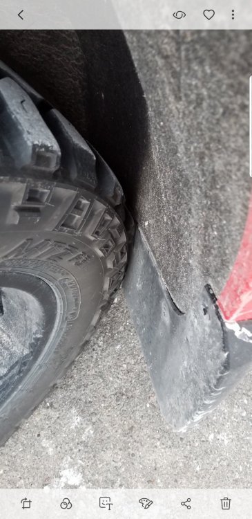

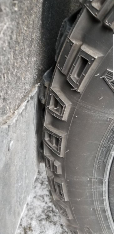

Below are pictures of my tires all full lock.  I have a stock height Trail Boss with 33.5x12.5 tires on 20x9 rims with a 0 mm offset.  It has a slight rub at full lock but it's not that bad at all.  If you have any other questions, please feel free to ask.
Edited by z1boss
Nice photos.  How do those 33×12.5s clear on the inside at the control arm or sway bar?  I assume that it should be pretty good with zero offset.  I'm trying to figure out what I would need to do to run 305/55r20s on a stock 20x9 wheel. I thing the factory offset is something like +27.
