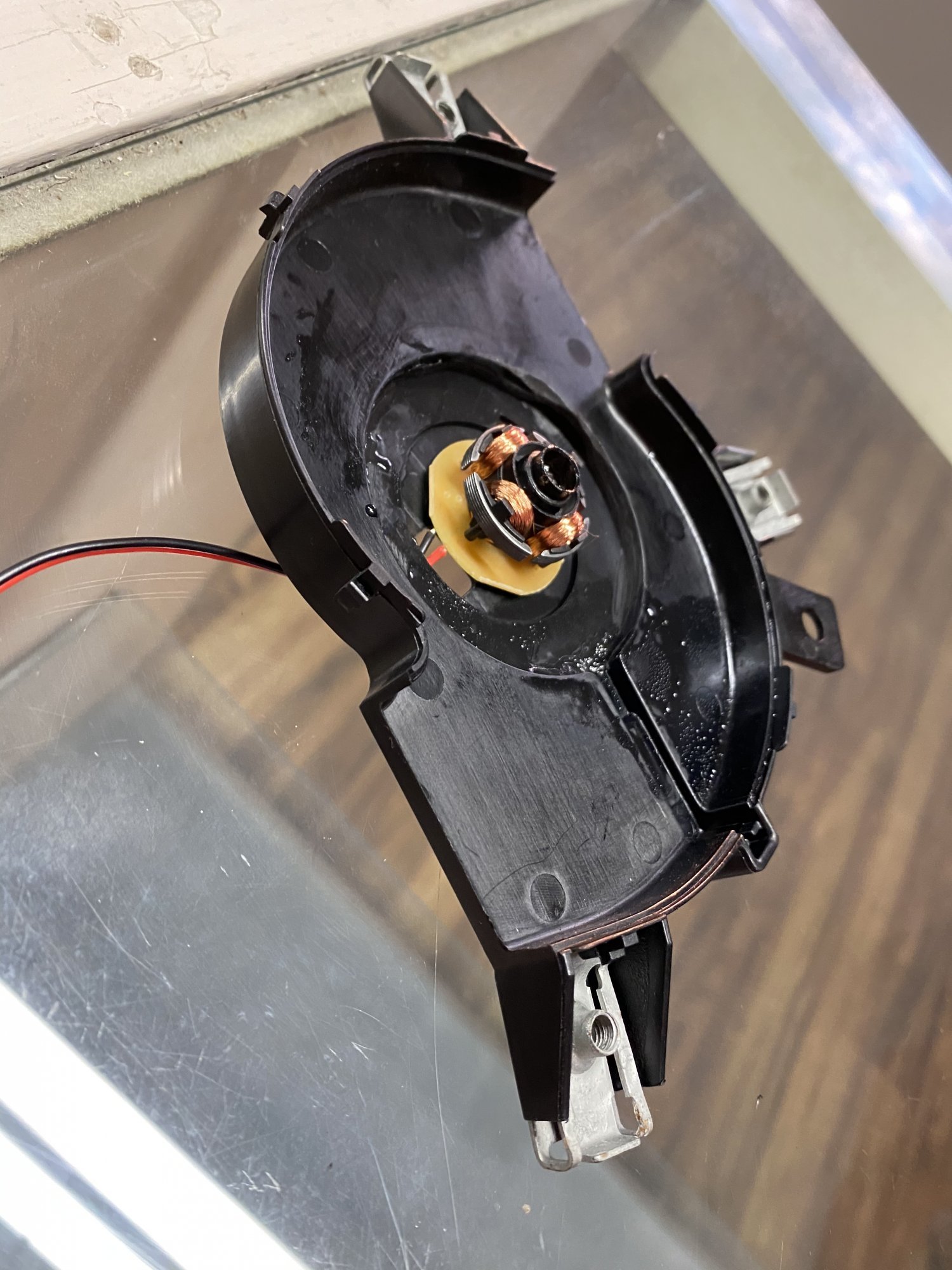

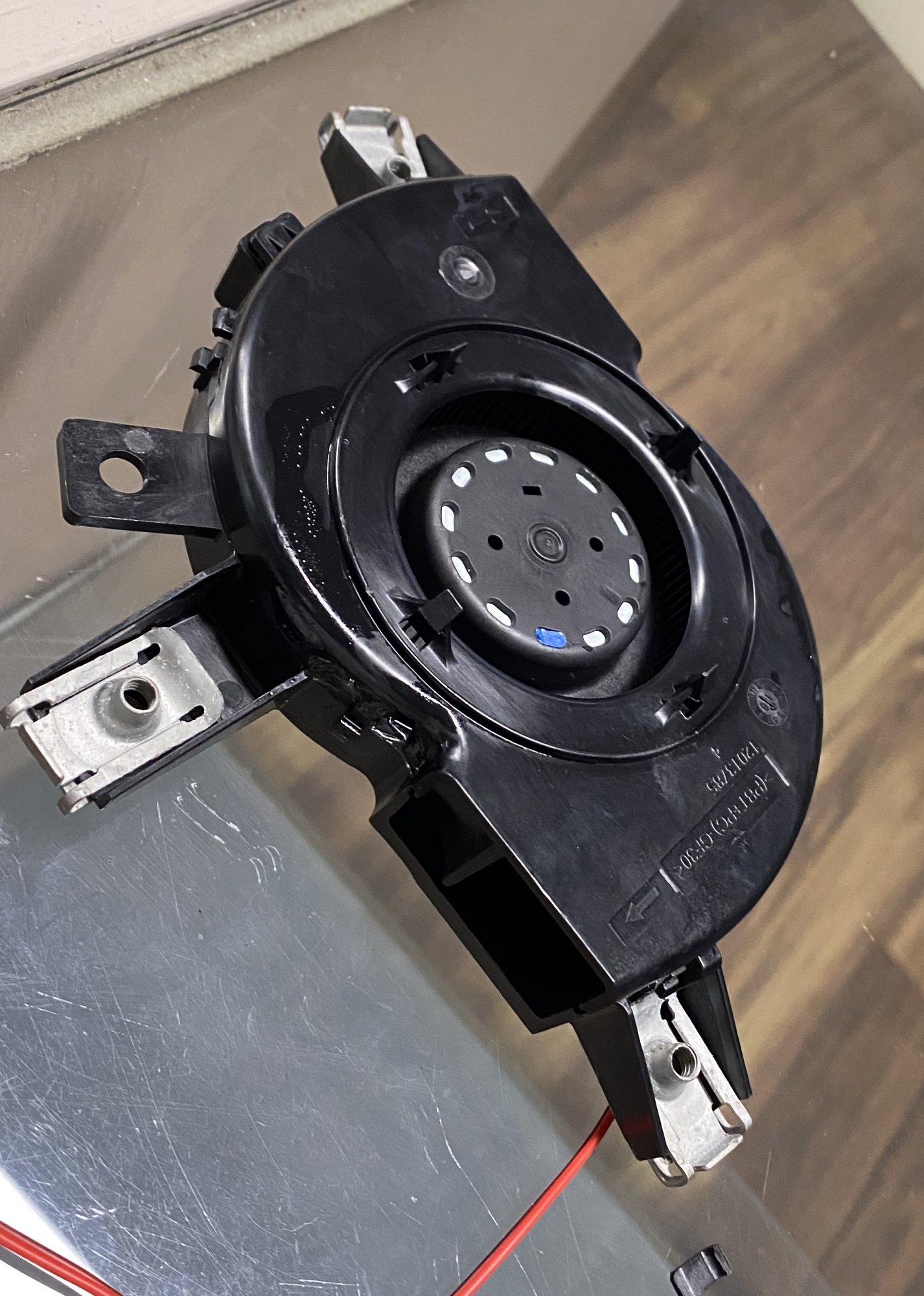

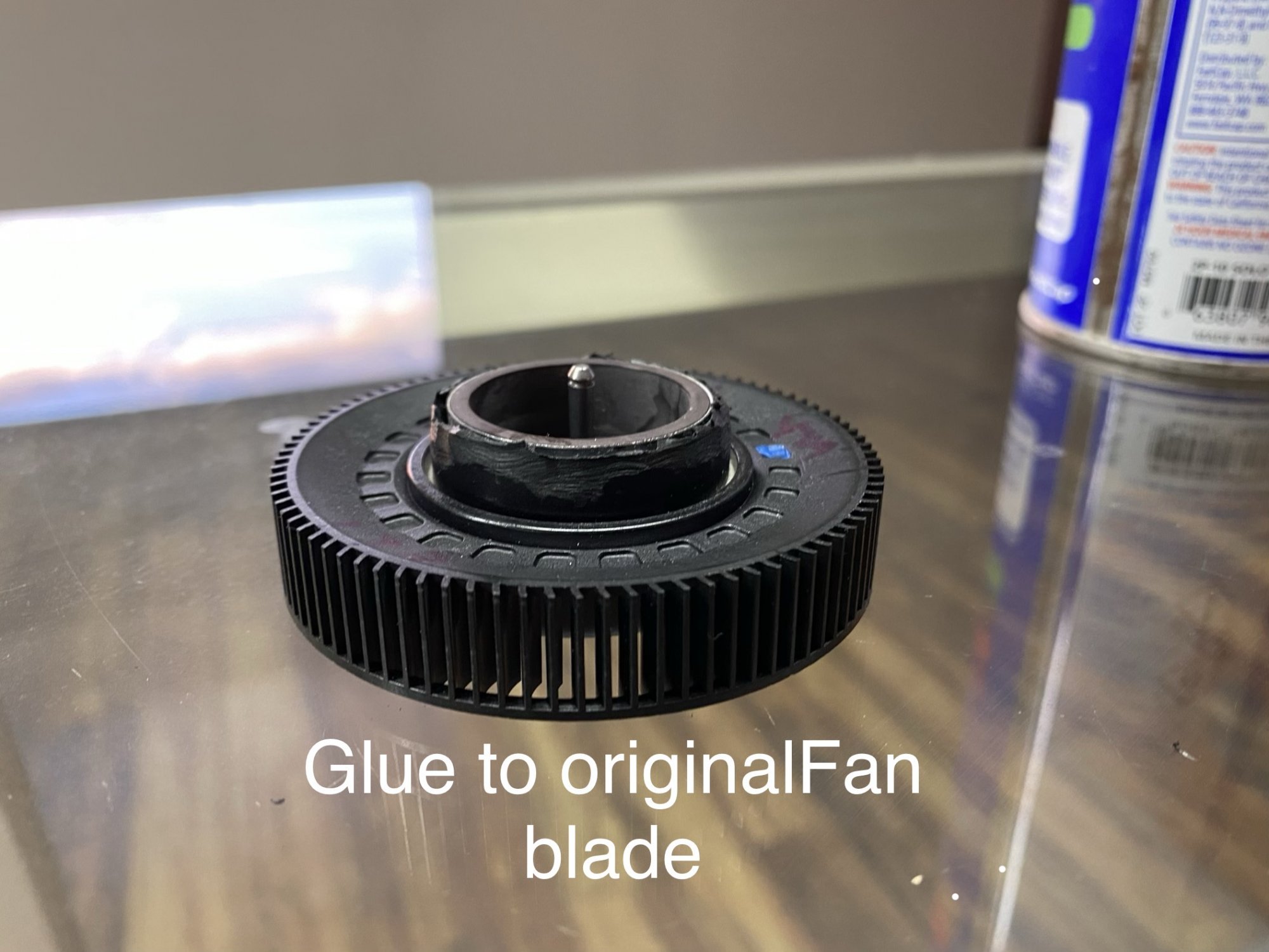

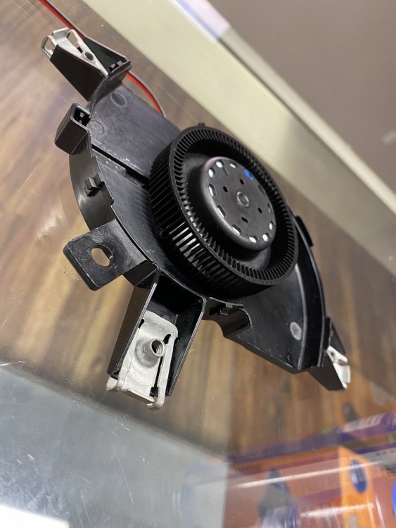

Hello guys,
just wanted to show you the way I got my seats to get the “ventilation” functionality on my 2017 GMC Sierra. I will attach pictures of what I did. Because the center of the original blade is bigger than the one from the fans I bought, I had to adapt it so that it could work. 91D15996-0EB3-4F04-9274-7BDF027023DA.thumb.jpeg.66030e0d7ebd86d944f3920a9fd57d7c.jpeg
Here I attached the base of the new fan to the one of the original one from the seati
