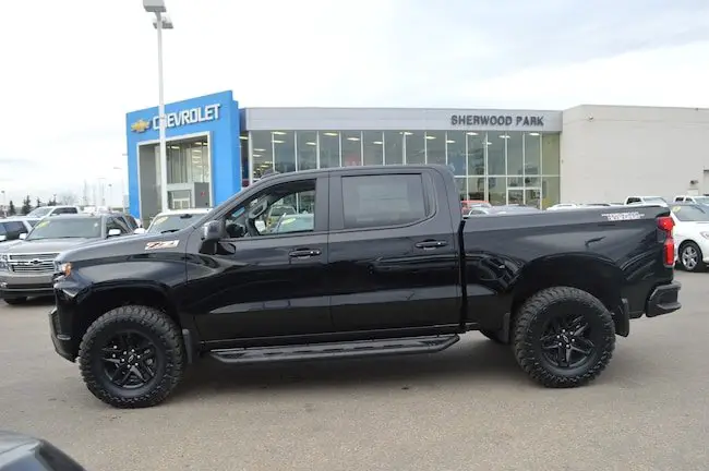

Trailboss +1" lift with 35 x12.5 x18
Great stance but I do wonder how they got the lift. The rear is already a lift block on Trail Boss trucks isn't it?
Yes block lift in the rear, no aftermarket company says any of their leveling kit will work o the trail boss.  This dealer gave the part number for the kit and after look up its a pro comp 2.25" kit but I don't understand how it is,
Maybe it deletes the OE lift components?
Most likely just a front level with the existing Trail Boss 2" Factory lift.
And a taller rear block. That is it. Simple as that.
Rough Country has a leveling kit out for 2019 T1.
