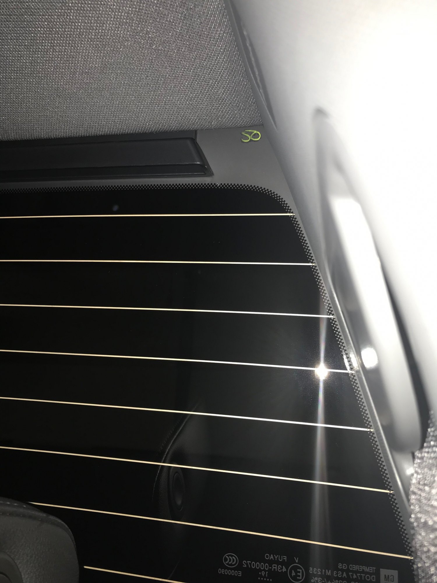

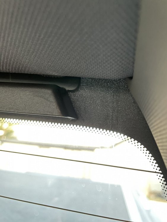

Got my truck back after a week and a half. I’ll have to take a better look tomorrow as it was dark when I picked it up. I’ve attached a pic of the new glass numbers as well as the top of the frame and a pic of the old frame... slight difference
Nice to see some physical changes being done to address the issue. Hope it’s the fix everyone’s been waiting for.
Looks like the same series as my 06/20 build:
Edited by Spyderwebb
10 minutes ago, Spyderwebb said:
Looks like the same series as my 07/20 build:
The frame looked to be a little thicker when I intitally looked at the OP’s pictures. No?

This is the first time I've seen the FUYAO E4's without the "wing". Historically, the FUYAO E2's did not have the wing, but the FUYAO E4's and the VIRTO E9's did.
If that is the case, then they are mixing glass versions with frame types.  ???
Is the wing the "redesigned" part?

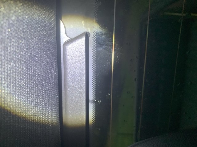

Interesting. My E2 has a wing but it looks different. 10/2018 build. Goes without saying that it leaks. ?D1653685-F820-4593-9F39-56ACBBE9BE4F.thumb.jpeg.e528d1203a1eecc06218cd48b0e13e8e.jpeg4C03E1EA-A17D-4558-B20C-26F9CACF3907.thumb.jpeg.ed79e7c7d109503f2a2b306be107686e.jpeg
No, the wing is my original window and the other is the new redesigned window.
