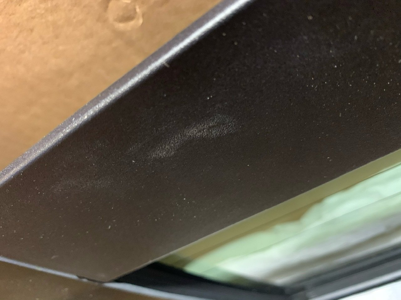

Well, update on mine. Went in on Monday for new exhaust, there was a rattle at cold start and they found something broke off inside... and the new window that came in. They fixed the exhaust Monday but didn’t get to the window... then on Tuesday their “window” guy had an emergency and couldn’t get to my truck. Then today I get a call that he removed my old window but when they went to get the new one they saw a hole in the box and then they found a “blemish” on the window frame on the outside portion. They texted me and sent me the pic I’ve attached and said that they don’t think I want that window and I said NO! So now I’m waiting until next Monday for the newest window to arrive! Ugh.... and so it continues.... I just texted my service guy and asked him to look at my old window tomorrow and see if there are any cracks and to send me pics as I’m keeping track of everything for when this new window fails and I have bullets for GMC....
