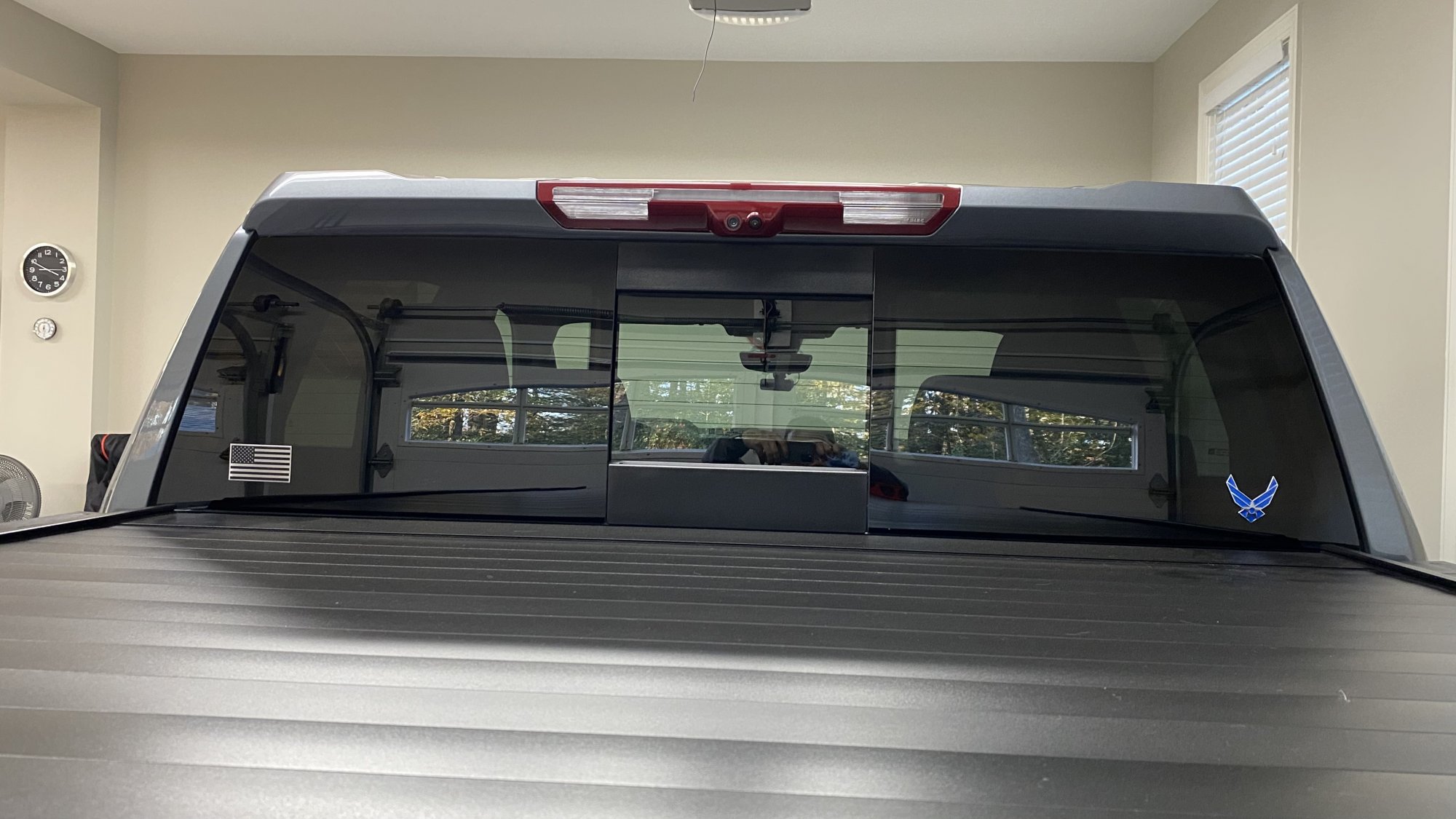

I’ve joined the leak club-6/20 build date Denali with slider E4 fuyao leak on passenger side with only 770 miles and no off roading or towing yet. After staying up to date on this entire thread I decided to tackle myself with painters tape on spoiler and glass edge and I used good old GE advanced silicone. Didn’t remove spoiler just cut tip to fit in groove and slowly filled (flows easily) until the top of glass edge. Removed tape and cleaned any residue with iso alcohol. Totally invisible repair and no issues with banged up trim or scratched paint. Longevity who knows but at least it’s leak free and easily removed if leaks again.

I did the Permatex 81730 flowable silicone suggested by another member in some earlier posts.
I had thought about regular viscosity silicone but decided on the flowable type to seep into every nook and cranny possible.
Modified the tip to be flat and to fit between the spoiler edge and the glass, with a hole on the bottom face and the end tip intact.
Taped up everything  as Kclyatt described and added some tape on the vertical seams at the top of the plastic /glass because it runs everywhere, hence flowable.
Did 3 seperate applications about 3-4 hrs apart, across the entire top of the glass, starting in the middle and working to the left and right.
The separate applications allowed the silicone to set somewhat  and allowed me to build up and fill the entire void to the top of the glass edge and down around the corners and down the sides for about 6 inches.
I think I used 4-5   of the 1.5 oz  tubes and used the same modified tip on each tube during the application.
Have no idea if it has helped, but figured it was worth a shot compared to some of the leak repair nightmares that others have reported .
Think I will order some of that cord  for the spoiler front seam that someone was kind enough to post a picture of and the Amazon link.
Good Luck guys and girls.
