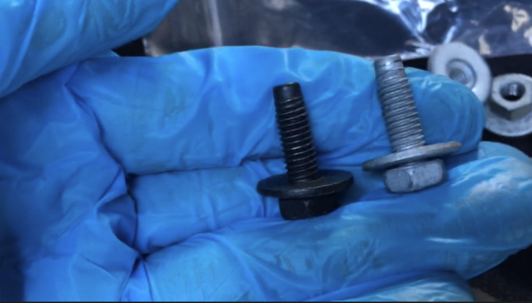

Well, I'd say I don't agree with the dealer.  It is true the bolts have a new part number and they are now black as oppose to the grey metal color.  These new bolts go on the 4 corners of the spoiler.
It may be that these bolts are one time use, I used them again and they weren't the cause of my leak.  But I will say it is the nuts that meet the 8 other bolts around the middle section of the spoiler are more likely one time use.  The white gasket or sealer is on the nut, not on the bolt.  When I removed the original nuts, the white gasket was completely dried out and fell apart.
In fact, none of the bolts have a gasket.  Only the nut side does.
I know.  Because I took the headliner down, water tested to find the root cause of my leak, removed the spoiler, replaced the nuts with the gaskets, all 8 of them.

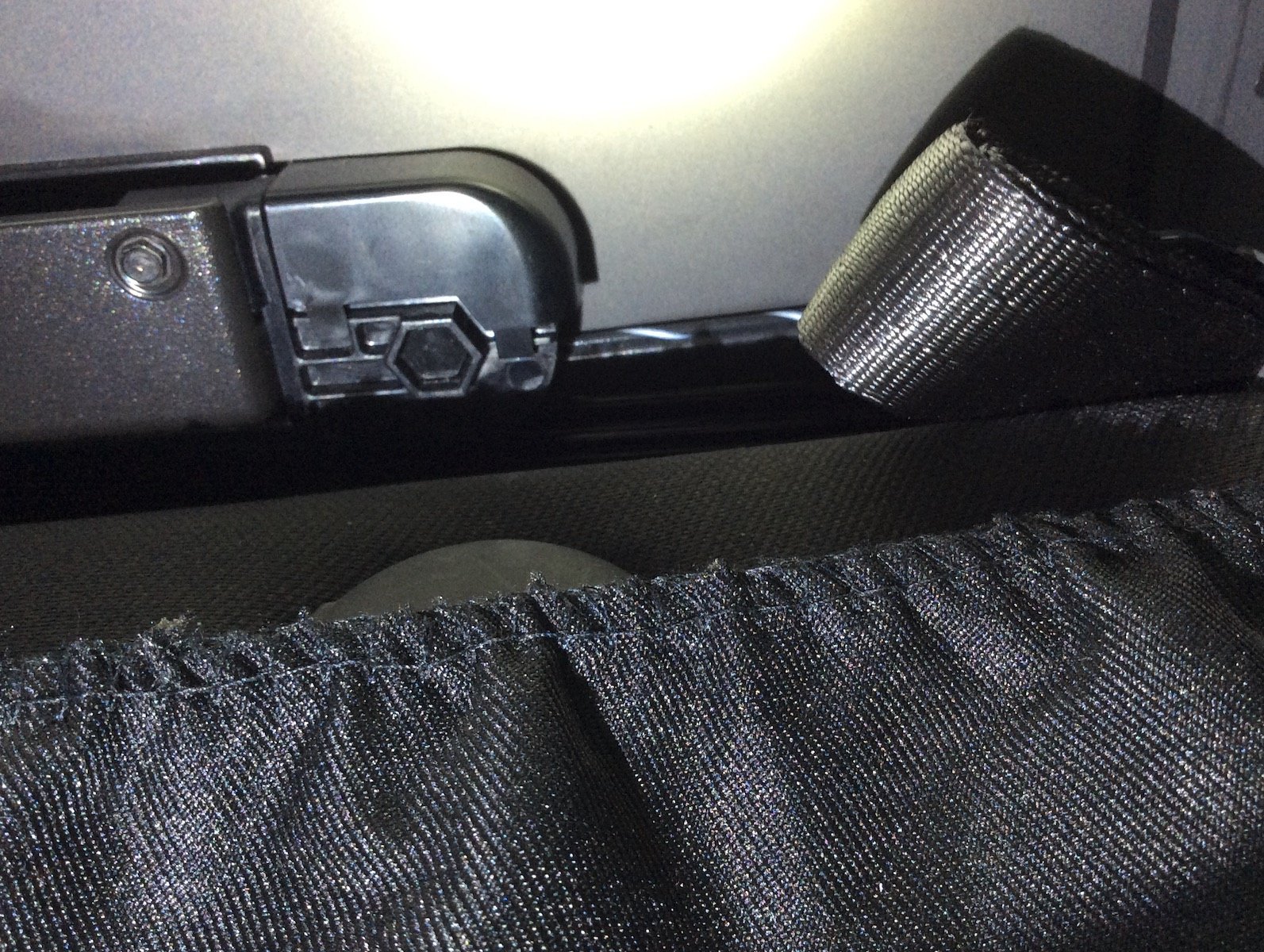

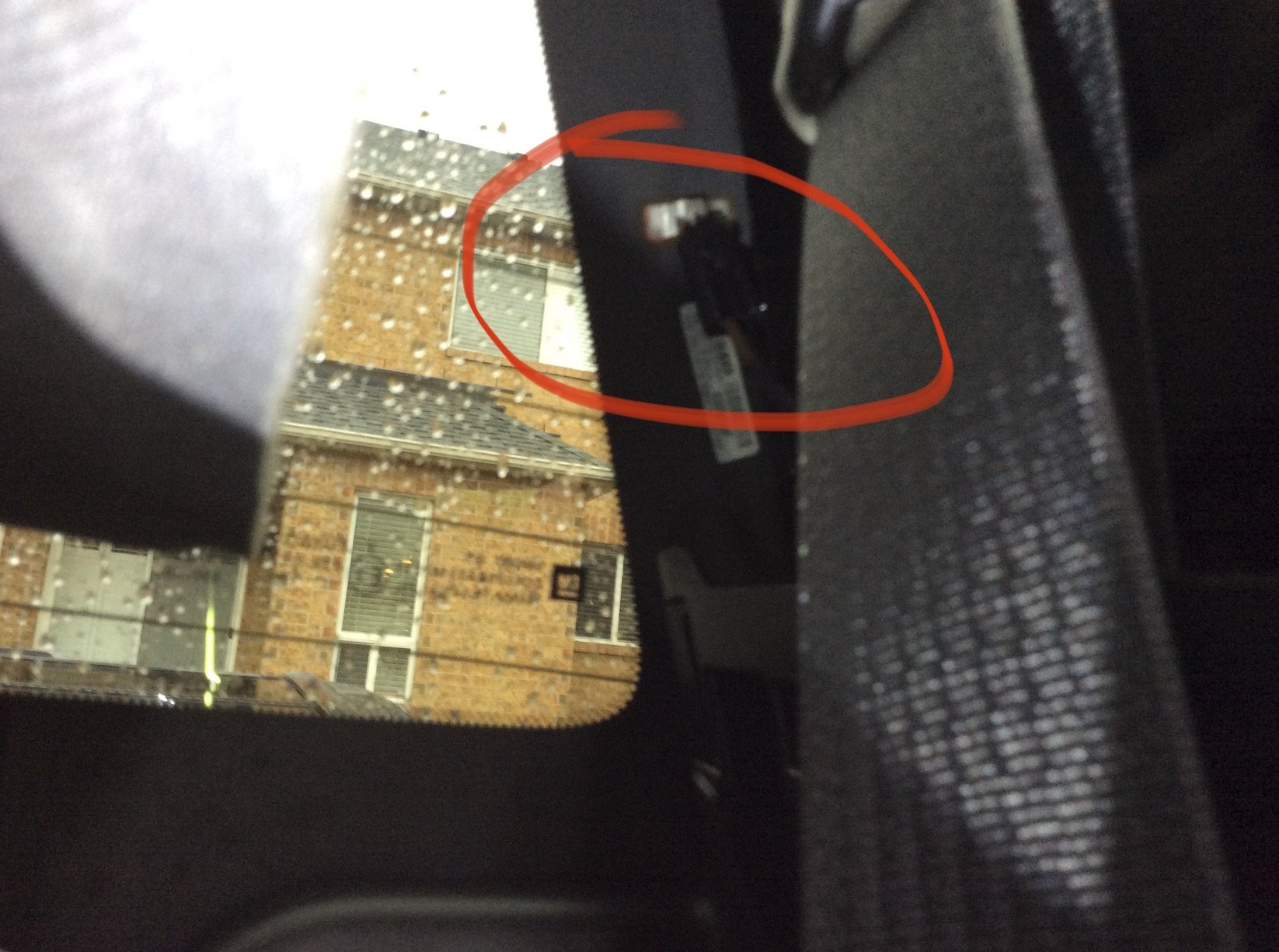

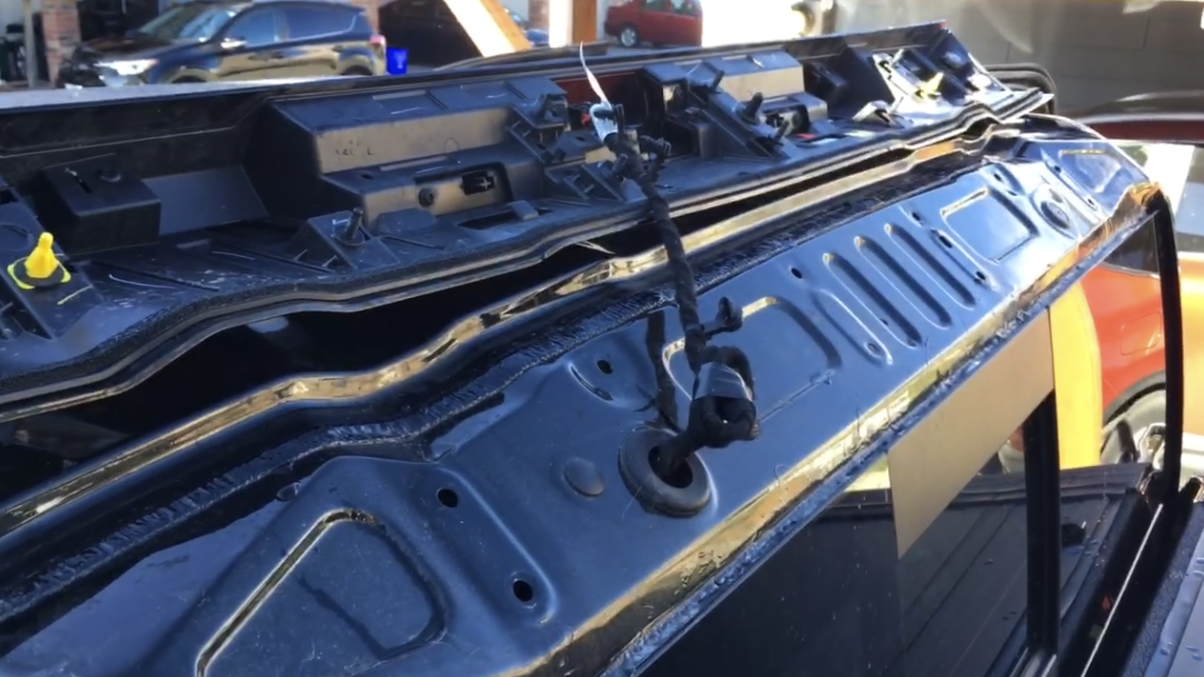

How does the rear defrost get power? Is there tow separate harnesses? One for the slider and another for the rear defrost? Spoiler appears to be the same regardless of which window you have.
Defroster has 4 connectors (it seems).  Two in the middle of each side and two smaller ones on the bottom of each side.  Took a pic of one side only, top and bottom.  The slider has one black with white swirl line coming out of the motor assembly at the bottom behind the driver side rear seat.  I don't know if you have to remove the rear bench to get to the connector as I was not able to follow the line down.
