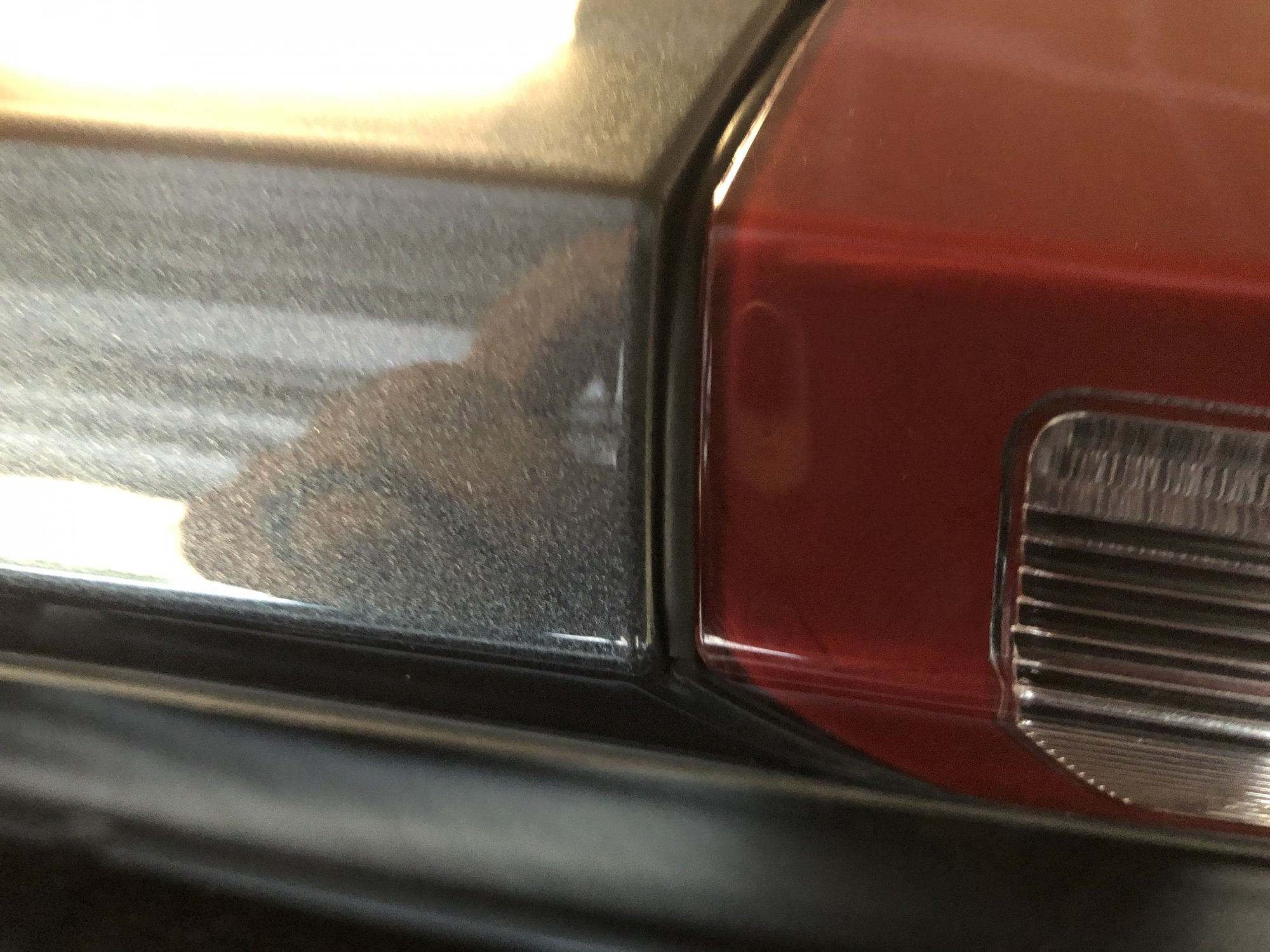

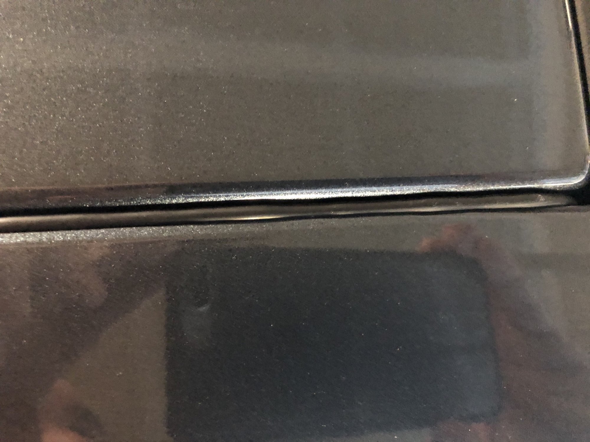

I ended up getting the top gap 95% sealed and I sealed up the upper portion of the brake light. Took using multiple pieces/sizes of the rubber cord and a hair dryer to heat it up in some places. I eventually want to find a softer material that will seal it in one piece, but I tried what I could with what I have. Only had the truck for 2 weeks but after it’s first wash and our first rain there was a small leak on the passenger corner. My wife is heading up to see family this weekend and it’s supposed to rain all weekend. Truck will be left outside. This will be a good test to see if sealing the top gap and brake light gap stops the leak.
Share some pictures if you can.
