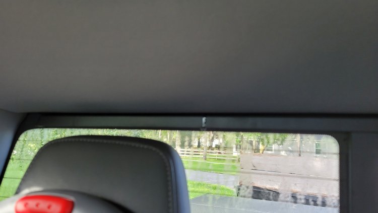

Looking at the pictures from the service bulletin I am convinced it is caused by water running down the top gap of the spoiler. It is either getting in the holes or cracks on top of the window. I am willing to bet that if a gasket/weather stripping was put in to prevent water from getting in that gap it would fix the problem. Someone with a leak should try to measure the gap and use something like this. That’s one of the first things I am going to do once ours if finally delivered.
1/16”? 1/8”? 1/4”?

I picked up my 2020 Denali on 8/30/20, its a 8/20 build.  The first day I got it, it leaked from the passenger side rear window, onto the plastic you talk about, and down the window.  I am 100% convinced that most of these power sliders leak on either side.  I had a 2019 Silverado prior, but it had the dark headliner, so it wouldn't have been as easy to notice.  This truck has the lighter color headliner, which is what made me notice the leak first, the wet headliner.
I took it in to the dealer, and they said "oh yeah" one of these.  Not very comforting lol
Somewhat mutually I decided I didn't want them to tear apart the headliner, spoiler, rear window, caulk etc to basically not fix the leak for good.  I think these repairs just put Band-Aids on if anything.  It would be nice for the 2022 redesign to have a permanent fix for this.

If you want to find the leak yourself there is an easy way. It will work unless the leak is under the spoiler where you can't get to it. Take trash bags and hang them behind the cab in front of the vent outlets. Tape them in place. Push folded fabric like a towel down between it and the bed to hold the plastic bag against the vent. Turn the fan on high. Spray soapy water where you suspect the leak is. You will get bubbles. With the vents blocked the fan will pressurize the cab.

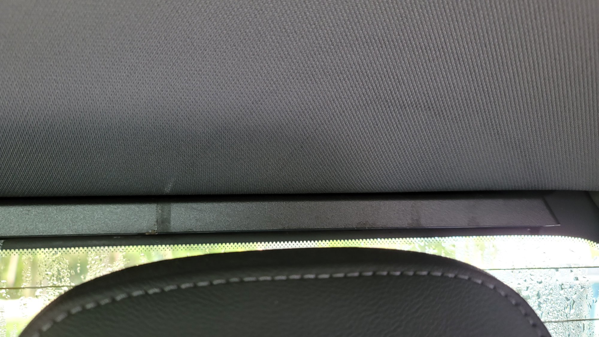

Dropped my truck off at the dealer this morning.  I did not get to talk to the service manager like I had hoped since I somewhat know him, but the advisor I talked to seemed to be familiar with the issue.  They called about an hour ago and said they put a simulated shower over the rear of the truck and found a "seam" that was leaking.  They re-sealed it and are letting it cure.  Now they are addressing the headliner as the wet spot/stain is very fresh and hopefully not an actual set in stain yet.  I'm personally hoping they can just clean it and not have to remove the headliner completely.  They are going to call me tomorrow with results.  Fingers crossed it is fixed, cleaned, and no further created problems
Got mine back today after 6 days. Was not the light leaking like advisor told me but indeed the window per my paperwork. Now I get to argue about the stains in my headliner that I was told would be fixed.
