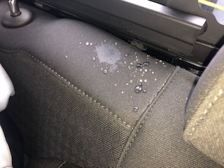

Well I though I might have got lucky with mine and got one that didn't leak. 2019 Sierra Elevation. Build date 7/19. I have had this truck for almost a year and yesterday it started to leak. After raining most of the day I saw a puddle on top of the seat. Not looking forward to this repair.

My 2019 AT4 build date 6/19 Fuyao E2 has been parked in my garage since new but after reading this post, I checked it in July and found it to be leaking. I've been driving around with a towel in the back window since then waiting for the dealer to get more experienced with the repair. I finally went to the dealer on a rainy day last week and the service advisor saw the leak on both sides and started to write it up. I questioned the repair and the service manager was consulted and he referred me to their body shop. I made an appointment with the body shop manager who stated they have done one repair to date but had to order the updated spoiler mount nuts. He called me back a while later to postpone the repair as there is no supply for the replacement nuts Canada wide. He said it could be weeks or months before they can get them from GM. Very disappointing.

Well it's been about 7 months since I had my 2019 rear window leak repaired.   It was a painful process and I am very hesitant to put it in a high pressure wash, but no leaks YET.   It's been in the rain 2 or 3 times, a quarter car wash with the high pressure wand 4 or 5 times as well as 1 high pressure automated (no touch) wash.   Nothing...
I took it to a new dealer the other day for some software updates etc and asked how many they repaired.   The guy wasn't shy, he said they were doing several a week and had a wait time around a month - three months on some of theirs.  He said the key was learning how to apply the new gasket for the spoiler \ light.  He said they really didn't replace many of the sliding windows.   I'm sorry so many are going through this still but eventually they get it right.  Don't hold your breath on them doing anything for you as far as compensation, I tried.
