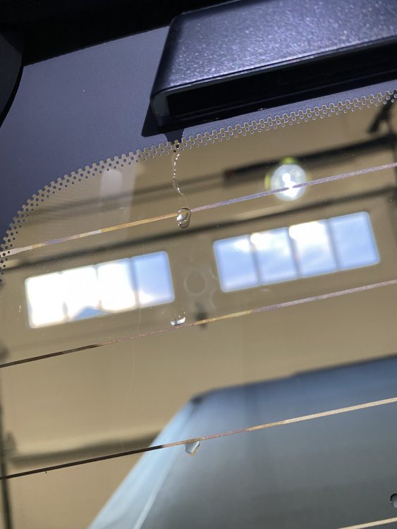

20 LT Trailboss 2400 miles with rear window leak on driver side. Water is weeping from the top track of the slider. Dealer has had the truck for a week and told me they’re pulling the rear window to reseal it and check for cracks. Said if it’s cracked they’ll have to replace the window. After reading all these posts I’m very doubtful this is going to be fixed

My 2020 Trail boss is leaking at the same spot as your truck. Truck has 2400 miles on it. Dropped the truck off last week at the dealer I ordered and purchased from. Told me they we’re gonna have to pull the rear window and reseal it. Called me yesterday to tell me it was done. Went to pick it up today and found what looked like they just applied the sealant from the outside to just the corner of the leak with out pulling the window or the rear brake light. Needless to say the truck is still sitting at the dealer
I had mine in last week. They told me they had to order a window and would call once it arrives. It has been raining here all day. I'm sure my truck is a fishbowl right now. I'm not impressed.
Does anyone actually know what causes the frame around the window to crack? Pressure/stress? Heat from the defrost? Maybe water freezing in the northern states?
Not officially, but I believe 100% it’s flex in the structure. Nothing else makes sense. That’s why further revisions of the window haven’t solved it, it’s not a window problem. They took too much meat out of the structure to save weight.
