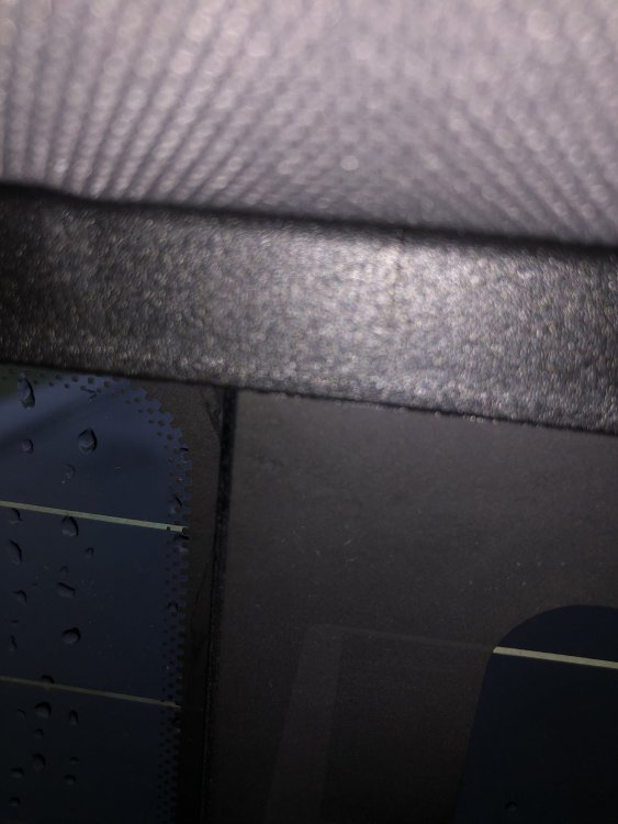

I had mine serviced last week they filled it with the sealant and since we’ve been getting rain here in Texas the last few days I’ve been looking it over real good and it’s not leaking but it’s only been a week. Since  it’s been serviced now I see 2 good size cracks in the plastic window frame needless to say I will be calling the dealership to get another appointment there gonna have to replace the window I didn’t spend the kind of money to have a cracked rear window also I see lots or rust on the window as well.
Kind of have to zoom in to see it. Idk why the camera has a hard time catching it looking at the window it’s plain as day.
