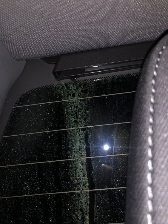

Well add me to the window leak list owned it for almost a year a week shy of a year to be exact small leaks in the corners going to make an appointment today and since the windows leaking gonna have them look at the spoiler that’s popping I wasn’t going to mess with it since the window wasn’t leaking but now that it is they can fix the spoiler issue. Also my truck was bought as a service loaner and the window has yellow number on the drivers side makes me wonder if they tried to fix it before won’t let me upload both pics
As you can see it’s a very small leak doing the exact same thing on the drivers side in the same exact spot
