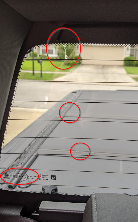

US Built also. 79921a454e08efa0fd6b5204476246c4.jpg291780c02ee4ea19b6f44d9a75d4b755.jpg

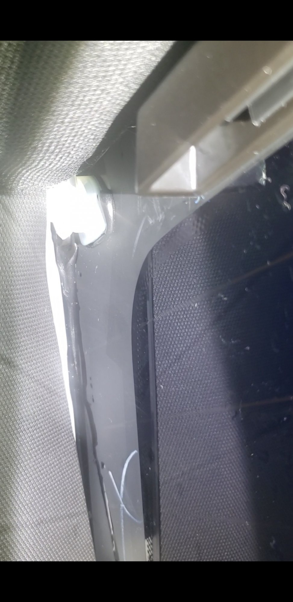

Well, here we go AGAIN. It is leaking again today. To make sure I wasn't crazy, I wiped the outside with paper towels clean with one hand and touched the inside with the other to see if I could interrupt the stream. After wiping the inside top dry, more came down on the inside. This will be attempt #3 for them to fix it. They've done the caulk job and then the full replace. We'll see what they do this time.
If you're going to check for rear window leaks, why not do it this way?572c85720db9b278118301215cdc0457.jpg
