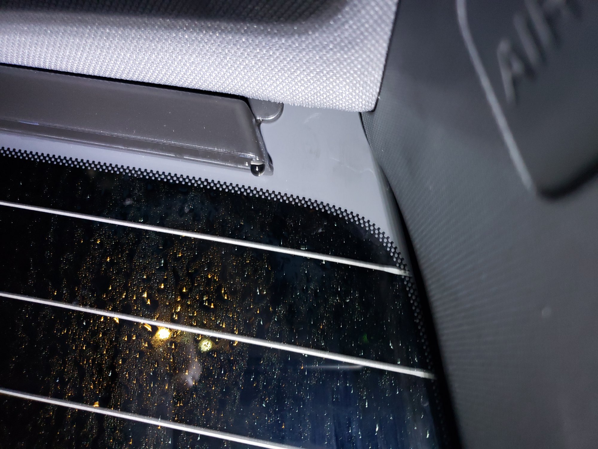

So I was washing my 19 TB that was made in Indiana and found that my rear window is leaking a small amount. Just a drip or two on the inner back window on the passenger side.
would you guys recommend just watching it for now since it is minimal? I have 2 years left on the warranty. Thoughts?
It's probably only going to get worse. You also don't want the water to accumulate, damage the headliner and potentially have mold build up. I would get it checked out and if the dealership is willing to change out the glass completely then might as well get it done. From what others are reporting, the full glass replacement seems to be the only real solution.

Yes, get it fixed. I had good luck with the dealer and tech I use. They used the sealant and it has held up fine and not had a leak since on my 19' Sierra. If they know what they are doing you do not have to have the whole thing replaced. I've already heard of people that have had the same issues with replacement glass doing the same, plastic cracking just like the originals. Still having to add sealant to them also, so go figure. If the tech knows how to put on a good bead of sealant, it should cure the problem. Can't believe some of the stories I've heard on here about some of these dealers service practices. Good service dept/tech can fix this right the first time, but obviously there are some questionable ones out there that don't know how to do their jobs. I would have done it myself if it had been out of warranty, not a difficult job. Still, a new truck should not be leaking water though, just a bad design that I had hoped would be fixed going forward. Still love the truck though.
I just washed my 2019 and it was bone dry inside.  I sprayed plenty of water from all angles to see if I could get it to leak.  Nothing.  It's just like my Jeep Wrangler.  Lots of people complain about leaking where the freedom panels sit, but I can't ever get mine to leak.
I got my rear window leak repaired a couple weeks ago by having the roof spoiler removed and resealed. So far after one truck wash and one rain storm, no leaks.
Fingers crossed.

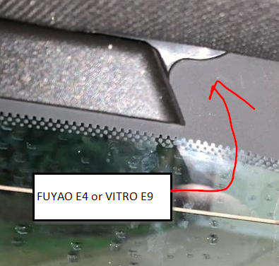

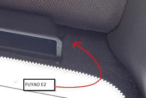

Looks like the FUYAO E2 model (older glass model) based on the shape of the plastic above the drip.
Looks like I have the vitro E9 on mine. Is that good or bad?
