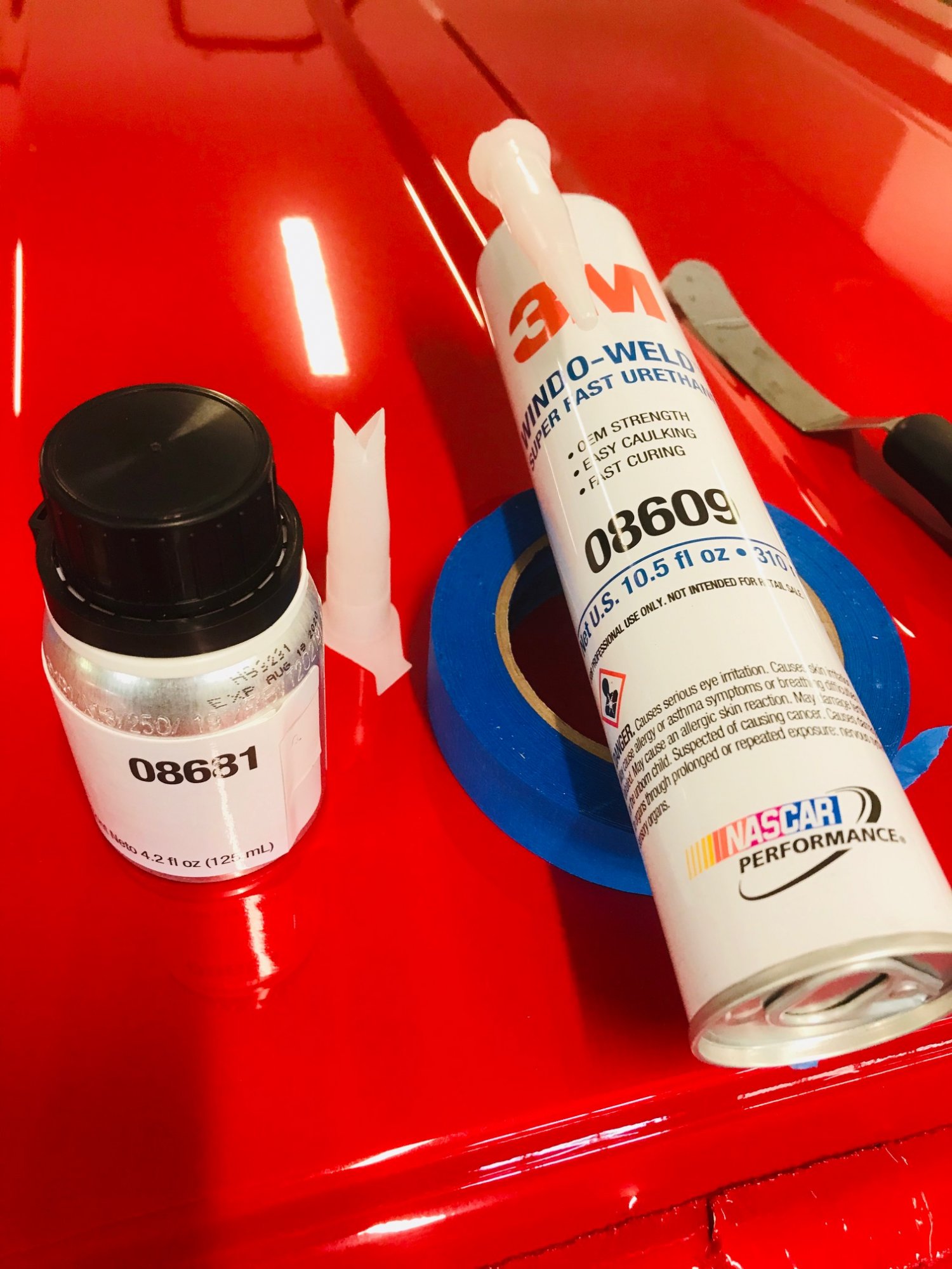

Today I finished up my slider to solid window conversion.  Would I do it again?  Yes.  But cutting the urethane seal to remove the glass is a pain and I'd leave that step to a pro next time to save the aggravation.  I can say confidently that these leaks COULD be fixed by removing the spoiler and sealing the top of the sliding window IF performed with the right products.  Replacing the glass is overkill.  But with a slider you'll always have a cracked window frame, unless the design is eventually fixed and the glass is replaced.
The TSB is incomplete in my opinion, the products recommended (Kent sealant) are inadequate and the likelihood that it will be done properly at the dealership is a huge gamble obviously.  If you want to seal the window frame then use a self-leveling urethane or seam sealer type product.  Sealing the spoiler bolt holes is also critical, although I'd argue the majority of leaks are probably the frames not the holes.  No matter who does the work, your headliner will have be molested, paint may be scratched removing the glass and something will probably break (a trim clip etc).

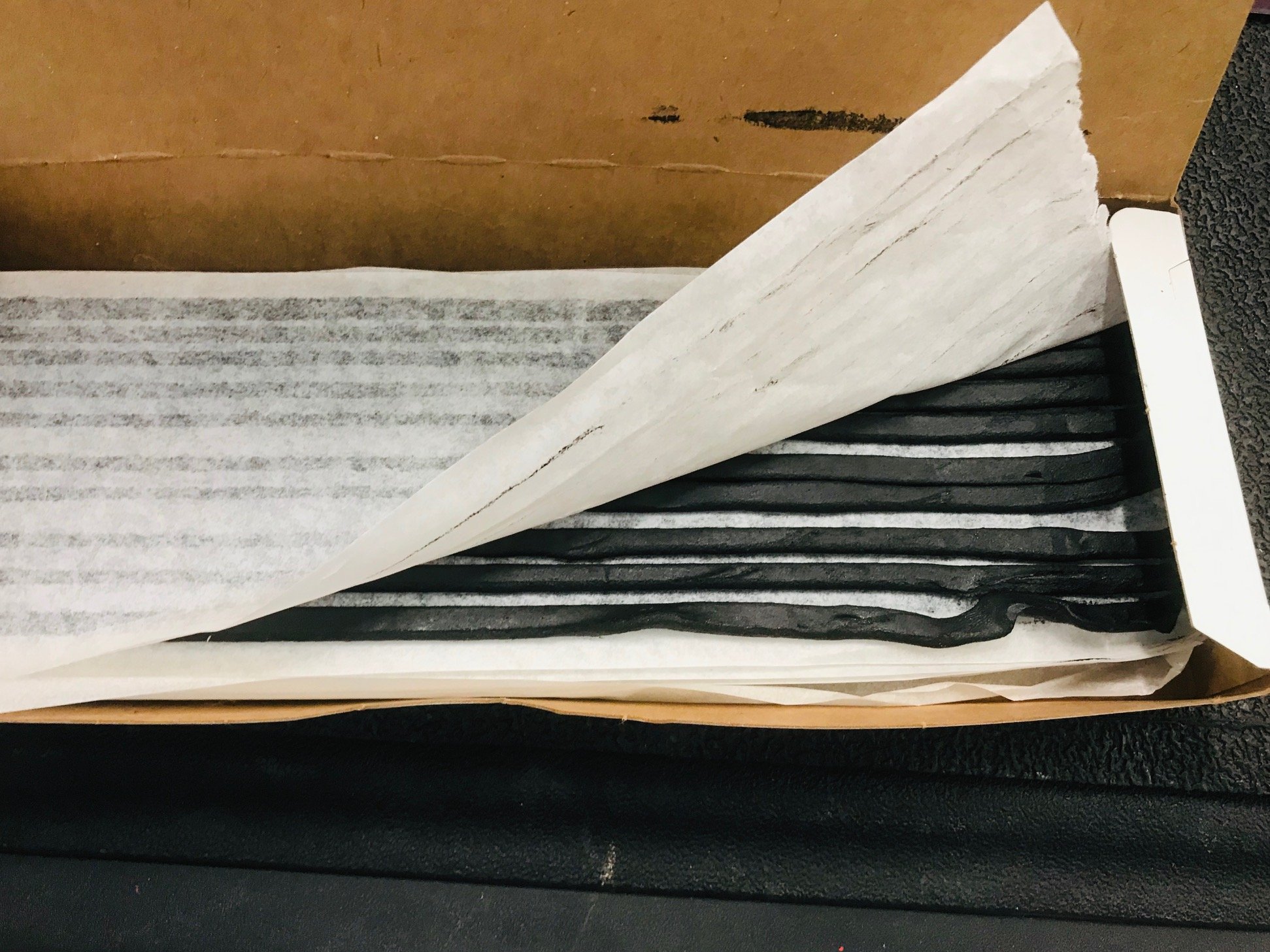

The solid glass cost me $257 and took a week to get through my dealer parts account.  I spent about $120 on 3M products and specialty tools.  I used 3M urethane primer, 3M window weld and 3M strip caulk.  One tube of window weld (sealer) did the job.  I rolled the strip caulk like play-dough and put it around all of the bolts. Once tightened, it squeezed through all holes and made a nice permanent seal.  After the glass had been in for a couple of hours and the spoiler was replaced and everything buttoned up I put the truck outside just in time for a huge rain storm and it passed the test.
Awesome job!! How long did it take you (labor)?
Great job Leevon.  This is why these forums are so great!

I had about 4 hours total into it.  Removing the seat back is a little tricky, the headliner is a little tricky and cutting the window out is a pure pain because the slider track limits access to the bottom seal.

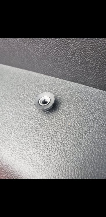

@LeevonI admire your commitment and work, awesome job, iam going to do some of your fixes to my truck, just one question man, are these the new nuts that gm is supposedly using they're black washers with silver nuts and have teeth ("teeth" because i dont know the correct term) on the outer edge, or should i re-use the silver flat no teeth slightly larger in diameter ones that are what came with truck ? Wish i had a pic of the original nuts. I got the new ones from my dealer, but i just don't trust them. They messed up the tsb pretty bad, they just squirted in sealant didn't remove the spoiler nothing, kinda glad they didn't, they would have messed it up even worse. i hope they gave me the correct nuts, just want to make sure.
Edited by abraham Lincoln
What is the part number for these nuts?
And is it just new nuts or new bolts too?
