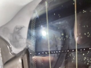

Well 2 weeks with the TSB done and it held up during some storms. Last night it rained. When I check it there was water again. It was not nearly as bad but none the less it is back at the dealer for the weekend.
it is definitely coming from the spoiler. Because I dried the window and then tapped the spoiler and out can a drop of water.
You can see the water following the contour of the window frame.
oh 2020 LT Trail Boss with 1200 miles on the clock. First repair was done at 700 miles. Only had the truck 6 weeks. Build 11/19

I don't own a T1 but my wife's Malibu had a similar problem that I recently did the TSB on myself by ordering the parts instead of going to the dealer.  The problem was they used the wrong nuts that with were not locking and with time and vibrations were getting loose. Also the gaskets were so thin as seen on some of the pictures here that the new ones are about 4 times as thick.  Here is the TSB for reference. Hope it helps if anyone suspects the leak coming from the rear spoiler.
https://static.nhtsa.gov/odi/tsbs/2019/MC-10165439-9999.pdf
Today I finished up my slider to solid window conversion.  Would I do it again?  Yes.  But cutting the urethane seal to remove the glass is a pain and I'd leave that step to a pro next time to save the aggravation.  I can say confidently that these leaks COULD be fixed by removing the spoiler and sealing the top of the sliding window IF performed with the right products and extra cleaning and care.  Replacing the glass is overkill.  But with a slider you'll always have a cracked window frame, unless the design is eventually fixed and the glass is replaced.
The TSB is incomplete in my opinion, the products recommended are inadequate and the likelihood that it will be done properly at the dealership is a huge gamble obviously.   If you want to seal the window frame then use a self-leveling urethane or seam sealer type product.  Sealing the spoiler bolt holes is also critical, although I'd argue the majority of leaks are probably the frames not the holes.  No matter who does the work, your headliner will have be molested, paint may be scratched removing the glass and something will probably break (a trim clip etc).
The solid glass cost me $257 and took a week to get through my dealer parts account.  I spent about $120 on 3M products and specialty tools.  I used 3M urethane primer, 3M window weld and 3M strip caulk.  One tube of window weld (sealer) did the job.  I rolled the strip caulk like play-dough and put it around all of the bolts. Once tightened, it squeezed through all holes and made a nice permanent seal.  After the glass had been in for a couple of hours and the spoiler was replaced and everything buttoned up I put the truck outside just in time for a huge rain storm and it passed the test.
