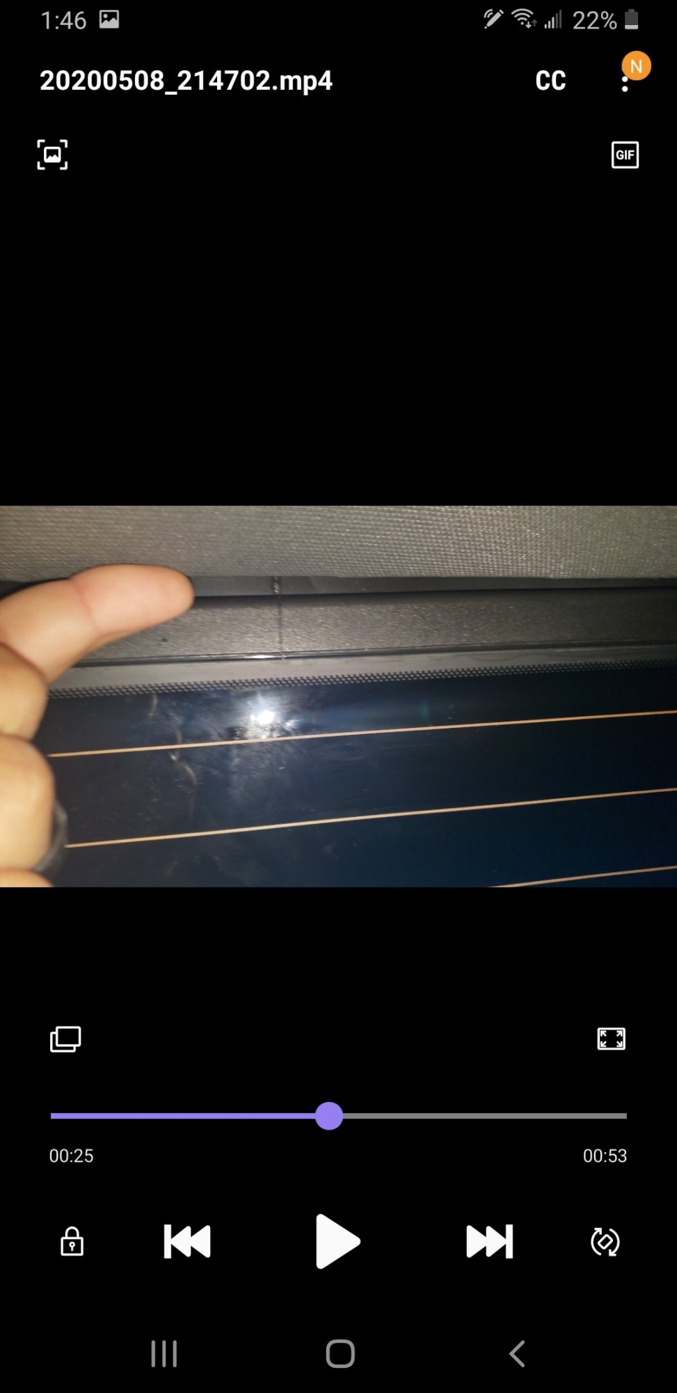

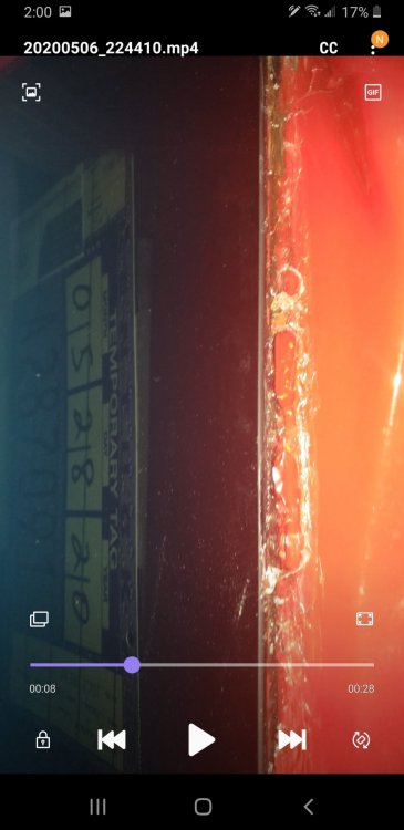

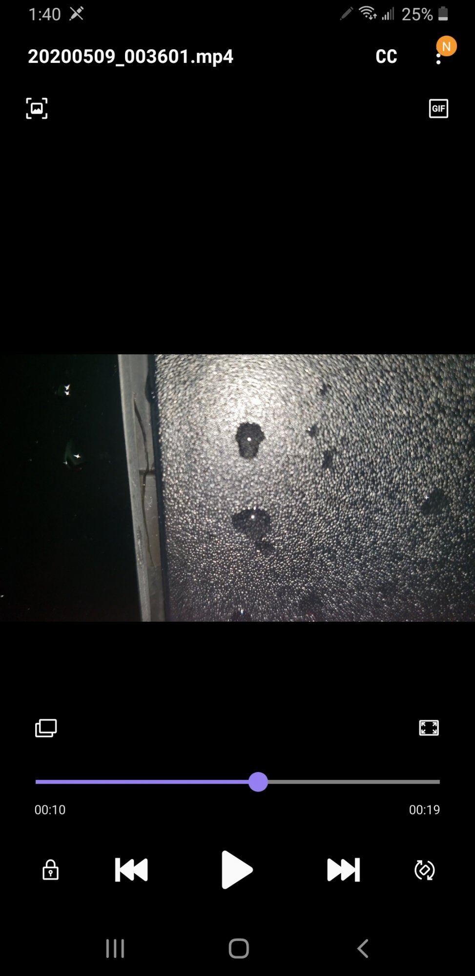

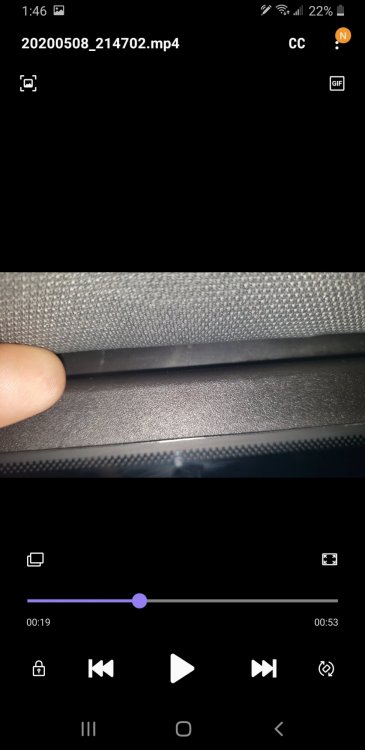

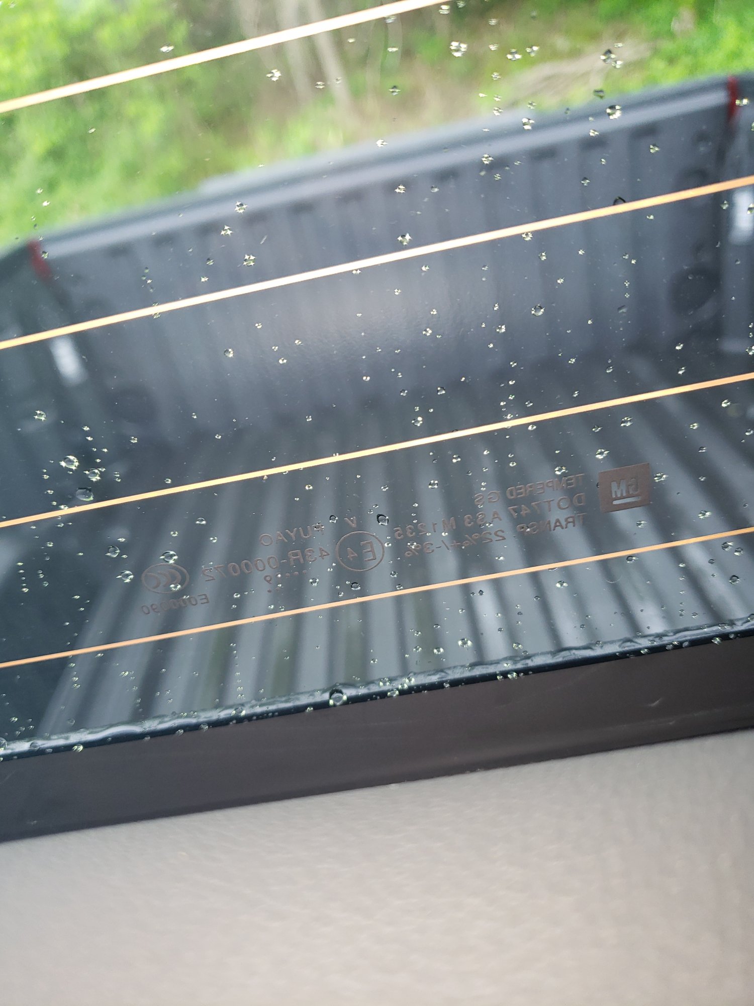

Cracks all over the frame inside and out, posted the pics so you all know what to look for. They are going to replace my rear window. No e.t.a as of today may 11th 2020.
all under warranty no damage to anything headliner, seats, they are all good. Sorry to the guys having lousy customer service, I've known my service/body shop dept for years. They tried to reseal it first but the guy they put on the job, just squirted some rtv silicone in there, literally didnt even clean the excess. I did the job myself later that day, followed the tsb, my service manager said it wouldnt void my warranty and gave me a tube of the recommended silicone, They didnt even bother to follow the tsb. And i wasnt gonna let them ruin it even more, if you want something done right you have to do it yourself, But you cant blame a whole shop because of one moron. I stopped the leak for now, now just waiting on the replacement window.

HOLY CRAP!!!!!!!!
I wouldnt have taken possession of that .  No freakin way.
M3 and the dealer GM and service manager would be having an in person meeting right on the spot.

Wow that’s bad. I went through a similar situation, bad caulk job that I got to stop leaking myself. Mine came along with damaged interior panels, paint chips and the sunroof shade no longer working.
Rear window was replaced this past week due to cracks in the frame all damaged panels replaced and feel like I’m whole again. The new tech did a fantastic job and there are actually less rattles in the truck then before which I am thankful for.

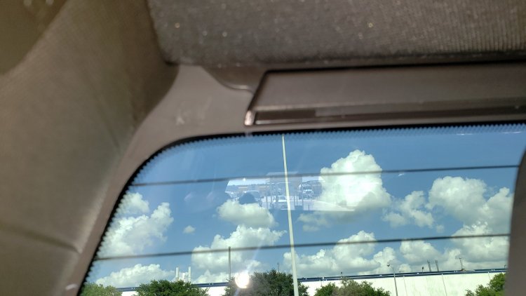

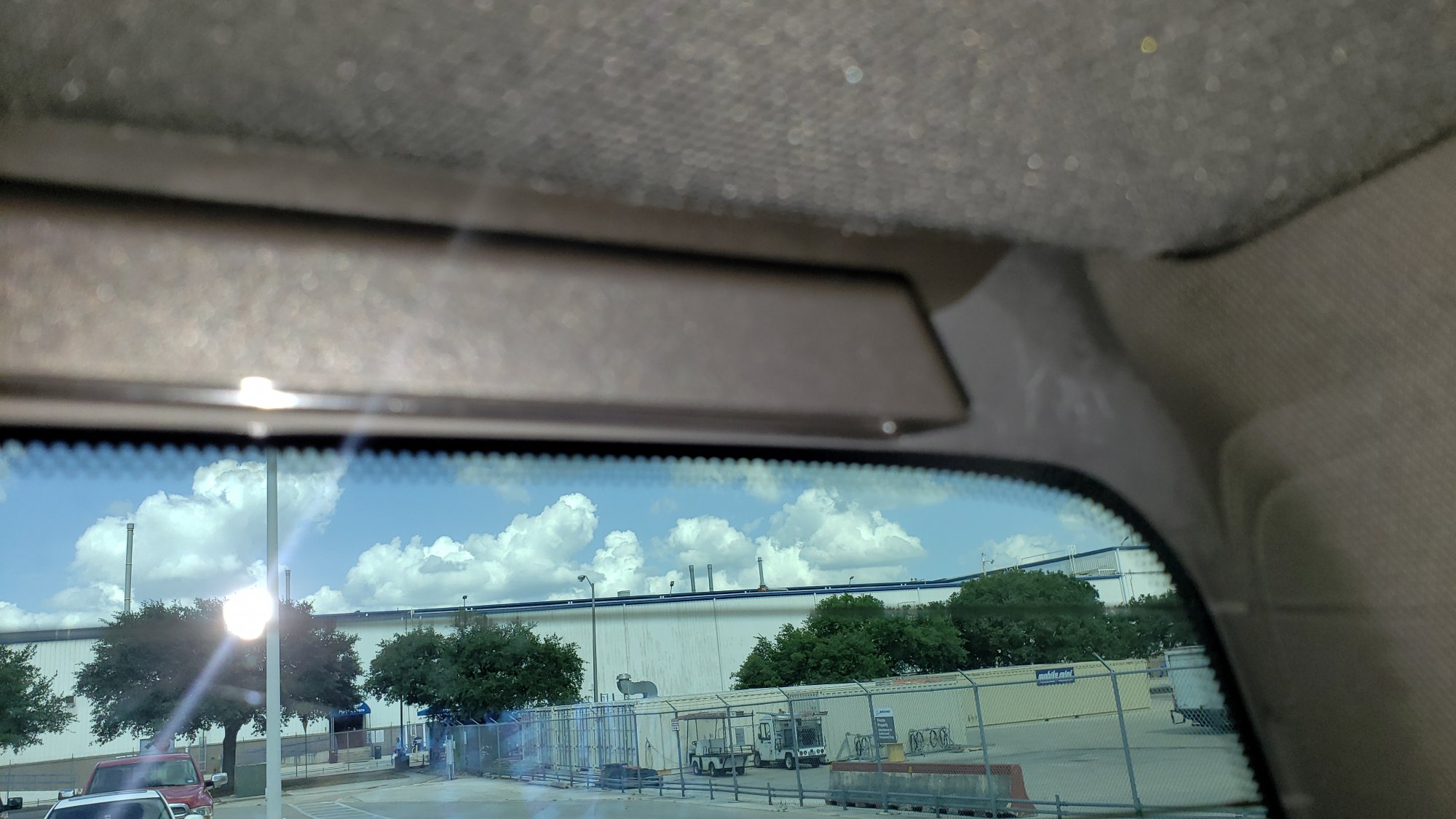

2020 AT4, build date 12/19. No issues yet, but I lose sleep daily over it. I paid a deposit before I found this thread, or I would be driving something else. I am trying to figure out what is cracking. What in this picture is the plastic frame that's giving everyone issues? If what I think is the frame, it looks a little different than others I have seen in photos on this thread. Also, I find it hard to believe headliners are being ruined from water coming in through a small crack; wouldn't that happen due to leak under spoiler? Maybe we have two issues.
Any guidance on what I see and what to look for would be appreciated. Thanks!
