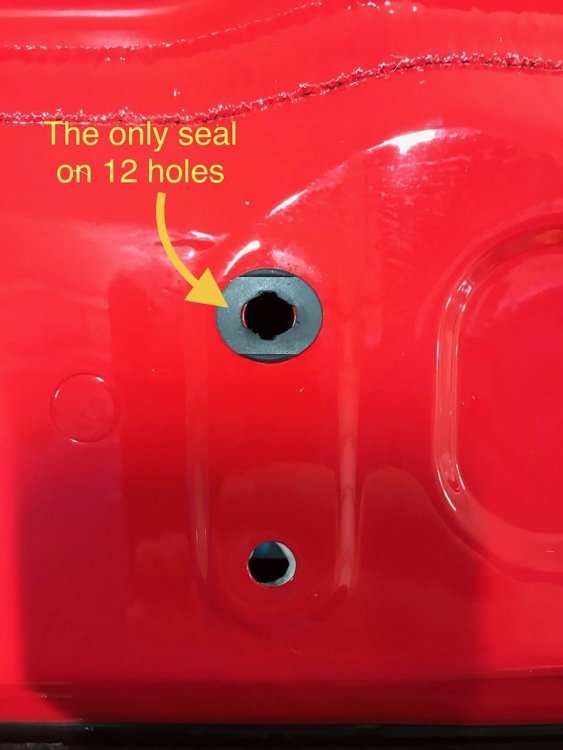

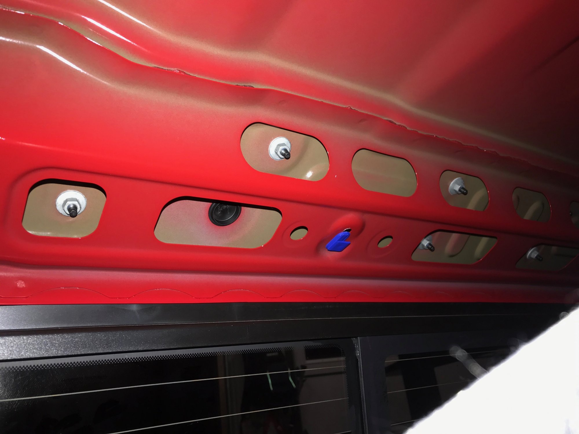

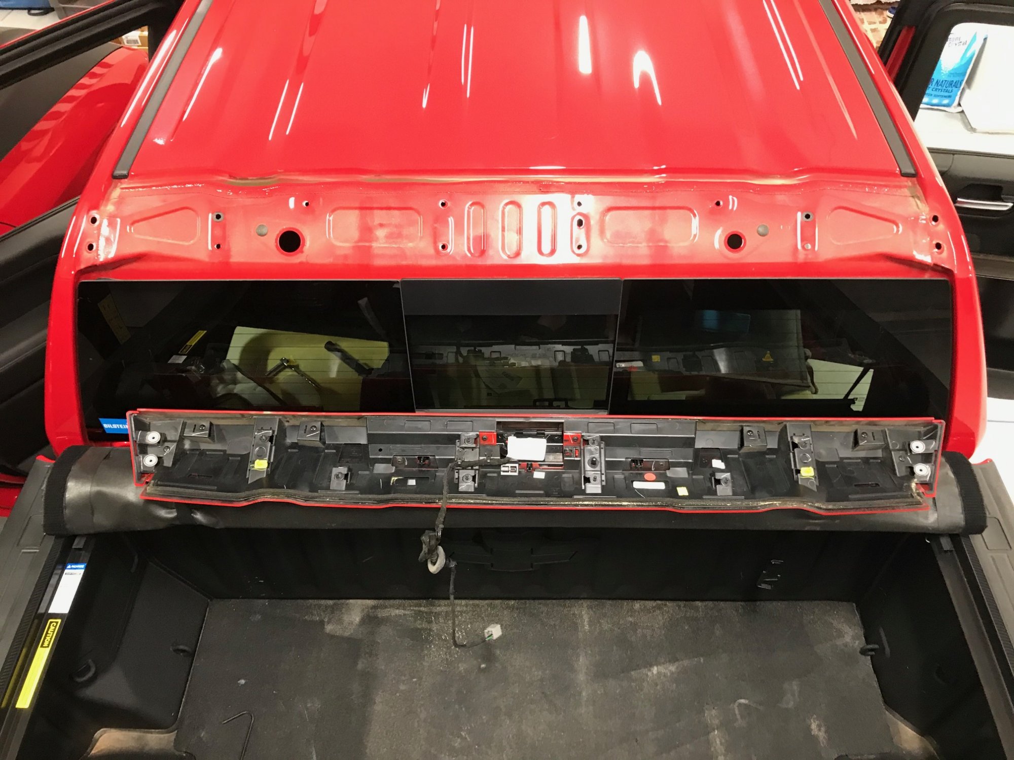

DIY Spoiler removal / access to the top of the window with some more detail than found in the TSB:
1. Remove B-pillar seat belt bezel
2. Remove upper rear corner of the door seal from the pinch weld to get access to first the B-pillar trim clips
3. Release the B-pillar trim clip closest to the door with a screwdriver to get them started or just pull the whole thing if you're brave (there are 3 metal trim clips on the bottom and 1 at the top)
4. Remove the small bolt/retainer holding wiring from the back of the B-pillar trim
5. Remove both rear coat hooks (un-clip the face from the inner most side with a small tool) and remove bolt
6. Pull the headliner down (you WILL have to molest it some to get it down past the window track) then reach toward the rear middle and give it some separation, there are two retainers in the back, now you have the rear mostly down.  Yes it will crease a little, it's not permanent if you're careful.
7. Using a long screwdriver and/or pry or trim tool with a light reach into the back of the dome light and separate the two metal trim clips.  Now you have adequate access to the headliner.
8.  There are 4 10mm bolts, 8 10mm nuts and 2 retainers.  The nuts and bolts are easy.  Long curved needle nose will do the trick on the retainers.
From there you can see just how piss poor the design of this spoiler and window is.  All of the water on top of and around the spoiler channels to the top of the window where there is a deep "gutter".  There is a lightweight foam sealer at the top of the spoiler doing little to nothing to route water around the dozen holes. You will also notice that there is little to no sealing on the many holes for fasteners and retainers in the roof.  I found 1, yes ONE! seal on the bolts.  The flange of the nuts in the spoiler have small o-rings on them.  This is all mind-boggling really.
Both side of my window frame are cracked about 6" from the edge, as most others have found.  The urethane window seal to the body is fine.   If you want to seal the frame yourself, you should clean out the giant "gutter" on top of the window with soapy water and a brush and forget about using crap silicone.  Get some self-leveling urethane or better yet body seam sealer that will adhere and remain elastic.  There is no way that Kent silicone will do any good long term.
If you're like me and you want to get rid of this crap slider, stay tuned I will post that DIY after the new GM solid window arrives.

Thanks, for the photos. Those holes look like the source of many headliner leaks. That's why I'll live with an occasional expansion "pop" instead of getting the dealer to monkey around with those seals that are not leaking.
Had those same thin crappy "O" seals around the bolts anchoring the spoiler on my Camaro. The way to go was to place a heavy blob of silicone rubber on the nut/washer and then tighten it....excess rubber just squeezed out and wiped off, but the holes are completely sealed from the inside-out.....and no more trunk leaks!
