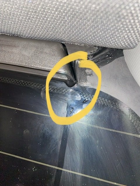

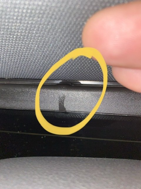

No sir, it has a plastic frame that is bonded to the glass, it's very thin and cracked in two places (that's the root of the problem).  It's garbage or I would have fixed and re-used.

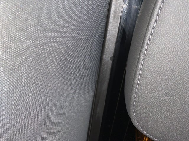

But my problem doesn’t end there. Now they have to replace the headliner since it is dropping in one corner and resting on the slider trim. They also cracked the cardboard of the head liner.

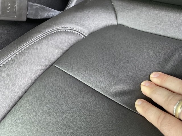

then I come home and find a scratch/slit in my leather seat. Someone must have had something in their back pocket when they moved my truck around.

The solid window is just plain glass squished onto the body with a thick bead of urethane, like a windshield.   The slider has a thin plastic frame permanently adhered to the glass (see photos).
