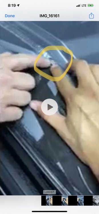

So we have finally found the source of the leak in my truck. I went to the service department yesterday to get an update and they took me back and showed me.
on the line of body seam sealer that was applied at the factory by the robots which sits directly under the spoiler there was a air bubble in it that popped. This was filling with water and then leaking through the seam to the truck. You can see it in the attached pic.
what they did was filled the void from the while with flexible dealer and then are also sealing it on the top also.
