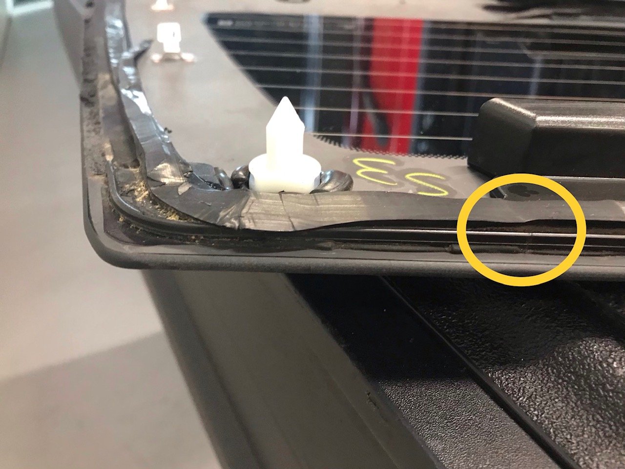

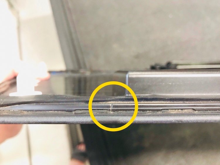

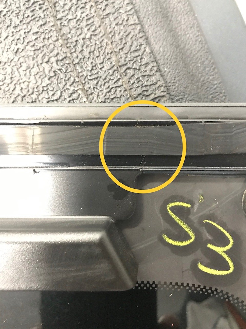

Does it not seam odd that GM is telling dealers to tell customers it is just the "spoiler" or "3rd brake light" or "window seal" to de-escalate fears or attempt to calm customers AND not admit that the window frames are actually cracking. Even if you look at all the service orders when they do the repair, it says "found window leaking, sealed or replaced window per TSB". They won't put the words "cracked window frame" in the receipt they give you. Why? We have seen these cracks in this thread. They have either found no way to stop it or refuse to look into it. It doesn't take over two years to solve why a plastic item is cracking if you wanted to solve it. If someone can prove this wrong or if GM was willing to be transparent about it, I will happily eat crow. But it has been two years. Everything @OnTheReel said is accurate.

169 pages is a lot of reading...I see a lot of theories and guesses about the source of the leak.  If you're confused by your dealership your service department isn't communicating well or they don't know or don't care.  It's simply a poor design of the window frame, you did nothing wrong by driving normally and you can't prevent it by avoiding hot or cold weather or opening your window.  There is a long, thin, flat and hard piece of plastic which is the "setting channel" for the window to body adhesive.  It's too long and is not designed properly for thermal  expansion and it cracks in the weakest spots on the top corners.   It hasn't been fixed.  Case closed.   Can we sticky my photos or my detailed posts about removing the sliding window and installing solid rear glass?
