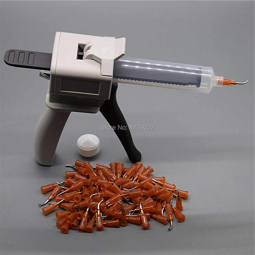

Was thinking about the flowable silicone, and maybe a syringe with a bent needle applicator to get it into everywhere without making a mess.  This looks interesting, and is cheap enough to try.
30cc-Manual-Applicator-Caulking-Gun-30cc
