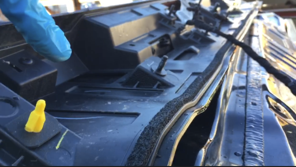

14 hours ago, SilveradoRST said:
There is some sort of spongy strip along that gap.  It is adhere underneath the spoiler itself and sits in front of the body seam when the spoiler is on.
When I water tested my leak, I notice water would flow over the top of the spoiler and then drip along the slant that slants back towards the rear window.  They end up on top of the rear window itself.  Weather stripping the gap would definitely stop a lot of the water, but it won't stop those drips sliding along the slant especially in a long rain.  Just my observation.

I'd say that spongy strip explains why long soaking rains are when most people notice leaks.
