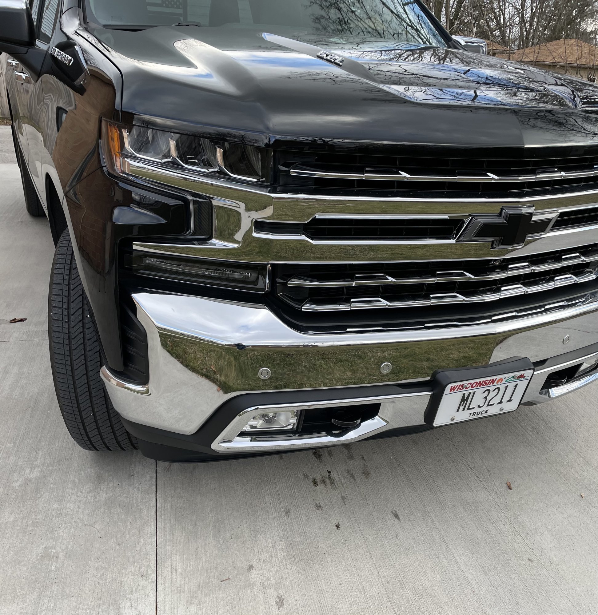

Added an oil leak to my window leak. Going for the 2019 hat trick I guess.90DE061A-6853-4676-93AB-502F10E1E24D.thumb.jpeg.77cf45f259a33de65a700b99e9f3d918.jpeg
Off to the dealer. Hopefully the line will hold another 20 miles.

That sucks.  Keep us updated.

Made it without incident and oil pressure intact. It’s dripping off the skid plate. Guessing oil cooler or line but they can’t look at it until tomorrow.
Not trying to hijack with my own calamities but I did think it was pathetic and kinda funny to have the thing leaking in two places at once. Oh well. ?
