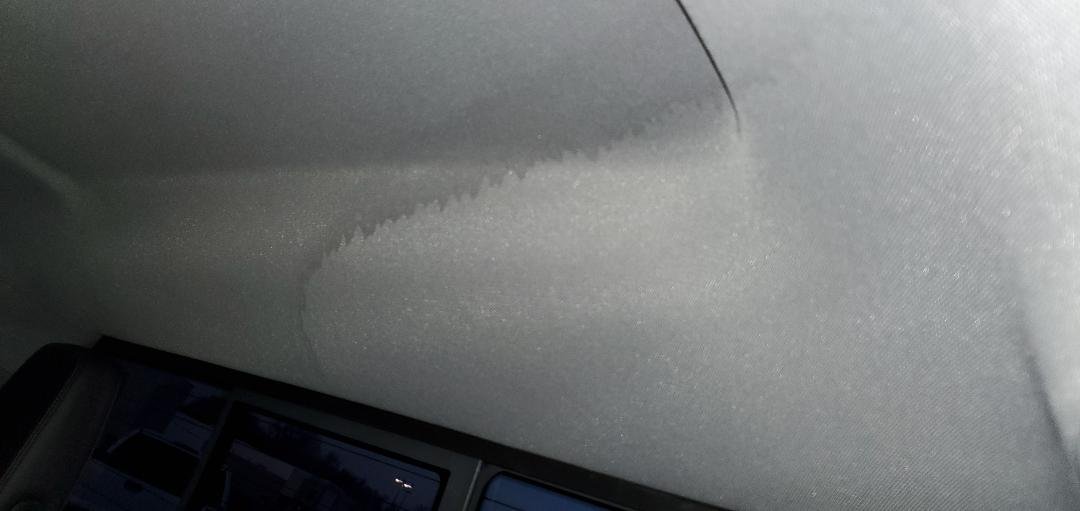

Just picked my 19 RST up from the 2nd sealer job, they were laughing that they "poked a hole" but could not explain where or what. They told me over the phone that the headliner was cleaned but still has a massive stain. I will try to get it clean myself. Now I will start the adventure of trying to trade it for a solid window. I need to clean the outside of the window because there is some sealer that spilled over but they can't see that apparently just like the headliner is "clean".
I would not accept that job.  That's horrible.
Yeah this is their 3rd time cleaning it...I just need to get it in a good enough state to get rid of it at this point. The window is going to leak again...

I wanted them to replace it at the beginning, I have been talking to Laura from the Executive Resolution Team, she talked to them twice about ordering a headliner but they ignore it along with not having listed on the work order. After seeing the work that they do, I don't really want them removing the windshield and trim just to destroy it all. Everything with this deal is a fight and like many other people we should not have to be dealing with this at all...
