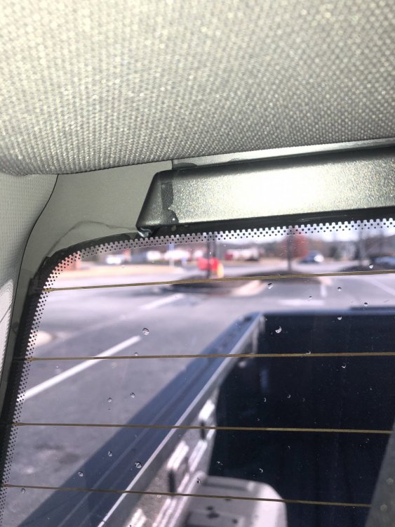

Update. The factory missed Over a foot of sealant in the rear window. Waiting on a new window. Dealer decided to just replace the entire window and have a glass guy do it. I’ll give credit to the service department for doing this.

Can someone explain why it’s so common for the sealant fix to not work? You’re literally plugging everything with sealant, it makes no sense. I can see maybe after some time the sealant shrinks or cracks, but what about this example where they do it and it fails the test right after?

The TSB(18-NA-383....) for the sealant fix that dealerships have to do is only step 1 to prolong this problem out of the warranty.  The next step is window replacement.    The fix so dealerships can get paid is the bare minimum and people have found its a better solution to do it themselves and seal every bolt, crevice etc.  Their fix is one bead line.

When I pulled my spoiler off I notice probably 5-6 inches on at the top of the slider where the tech didn’t put any sealant or it was barely there.  Once I filled the whole gap with sealant to the top of the glass all my leaks stopped.
Unless you remove the spoiler yourself, your at the mercy of the Service Advisor to tell you why the sealant failed.
In my case the dealership did a piss poor job by not only pushing the seal in when reinstalling the spoiler but not putting an even flow of sealer along with destroying my interior. I could have done a better job when I was 8 years old. Incompetence is the problem.
Gotcha, thanks. That’s what I was looking for. Seems like the dealer fixes (as far as the sealant goes) is due to them just being bad at putting the sealant on. Also seems like it works way better when done by the owner themselves.
I just didn’t know if I was missing something with the sealant itself having some property to it that makes it not work right. But again, seems like it’s the quality of the sealant installation that is mostly to blame.

Update: Picked up my truck yesterday for the second time. Their “glass guy” came in and confirmed that his previous installation was leaking and he resealed the window... kind of sloppily I might add as there is caulk on the rear glass and a little on the plastic frame by the slider. I’ll get it off the glass but will have to deal with it on the plastic. I asked my service advisor if he did the TSB as well, which I texted him the pdf that is on this page showing what to do, and he said no... he just resealed it. It’s supposed to rain like crazy today and tomorrow so we shall see. Kinda pissed that he didn’t just perform the TSB while he had it apart for the second time!

Add me to the list 2020 RST Z71 1500 miles leaking from the passenger side trim rail it seems no wet head liner. Truck goes in on the 29th as dealer was booked up till then. Can someone link the TSB for this? I did a quick search and didn't find it attached some pics...Just so happens that GM sent me the Quality survey after i found the leak. Lets just say i let them know just what i thought about their handling of a 2+ year old KNOWN problem. I also had the no start no crank with dic error codes in the first 150miles and they just replaced the battery and did a software update.
