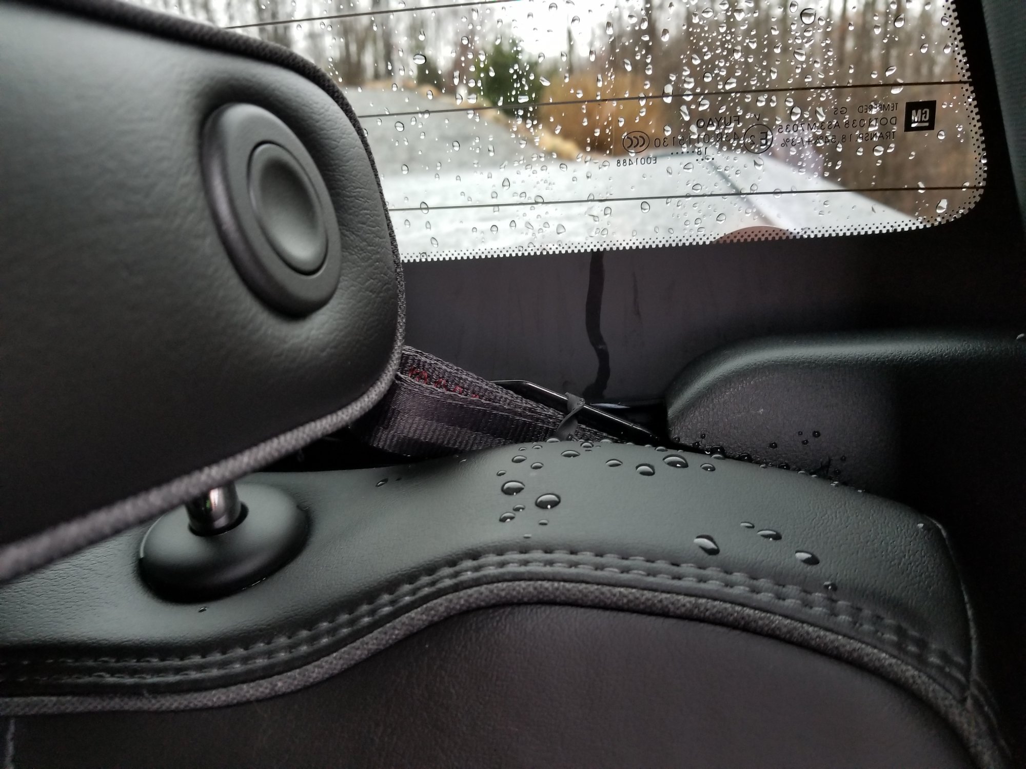

Chock up one more with a rear window leak.
On vacation in North Carolina and when I opened the rear driver side door after a full day of rain I found water atop my leather seats.
Thankfully it appears to small and coming from the very top corner. I've placed a folded up rag on the seat to hopefully catch most of it as it's supposed to rain the next few days and this issue will have to wait another week until I get home.
