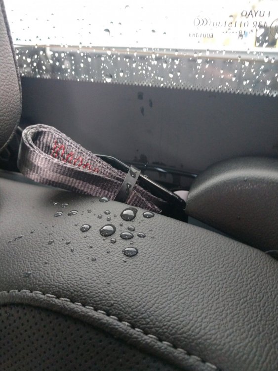

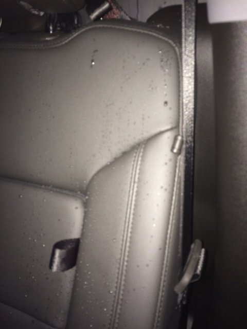

Mine is US built as well, I'm curious now if mine is going to leak. .   I wonder if one supplier was covering both the US and Mexico trucks?  I thought I heard somewhere it was caused by not enough sealant when they were installed but I could be wrong.  I've seen rear windows removed before and it was always just a rubber gasket.
The dealer told me that they had to put a new rear window assembly in because the old one had tiny cracks.  Others have said that was the case with them as well.  I know that the dealership first tried to reseal my window and that didn't work.
My truck is US built.
First attempt at fixing it my dealer removed and re-set the window. I also called GM customer service and got a case number. Still leaked.
Second attempt, my dealer removed the spoiler piece that overhangs the window and re-sealed it. Was told GM would not sign off on a replacement window. Also called GM customer service and had someone assigned to my case. Still leaked.
I sent an e-mail to GM's North American VP explaining my situation. The following day I had a phone call from GM Executive customer service rep. Long story short, my window was finally replaced. The dealer said that they found a hairline crack in my old window.
I just got it back on Saturday. I hope it's finally water tight. Hasn't rained yet though.
Still love the truck but it's been a very frustrating two months that is hopefully behind me.

I have the 2019 Silverado Trail Boss edition. It is currently in the shop for this repair, it leaked to the point that i ran down the back of the seat, entered the seat back compartment, over filled and ran out in the seat. Almost to water bottles full. I asked the dealer to replace the carpet and rear seat, but they refused on the seat and said the carpet could be replaced, but they would have to pull all the seats and consoles out and he didn't recommend that because panels could get scratched in the process. The way I look at it if there certified people scratch a panel, then they will have to replace it. He said they did the bulletin and applied the sealer because there were no visual cracks, but I think this should be a recall. I told him that I wanted everything documented so that if a mold issue pops up they will have to replace the interior completely. I just can't believe for the amount of money (myself)people are paying for these vehicles that we can't get better quality stuff, or the backing to take care of the issues when they arise. I have been a chevy/GMC supporter for a long time, but it just seems like I end up with issues buying new vehicles that should be flawless.
