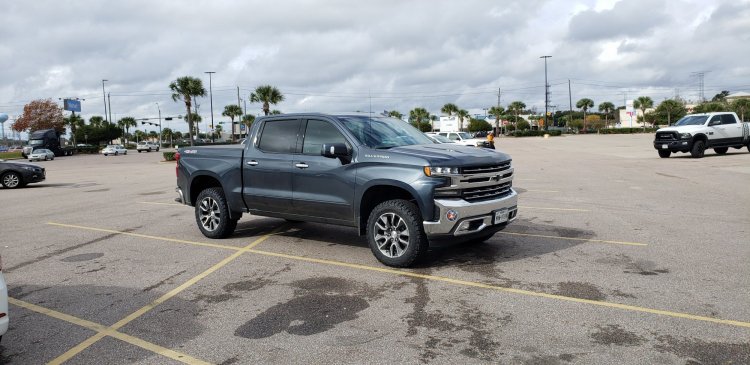

I put a leveling kit on my HC and it was about 1/2 inch high in the front. Yesterday I put my toolbox and all the crap that stays in the back and now I'm almost 2 inches high in the front. Is there a 1.5 inch block/lift that I can add in the rear to get me back close to level?

The dealer put my leveling kit on before I picked it up. I have looked for a brand name but can't find one. I measured from my carport floor to the rear fender (38 1/8 inches) and from the carport floor to the front fender (40 inches).

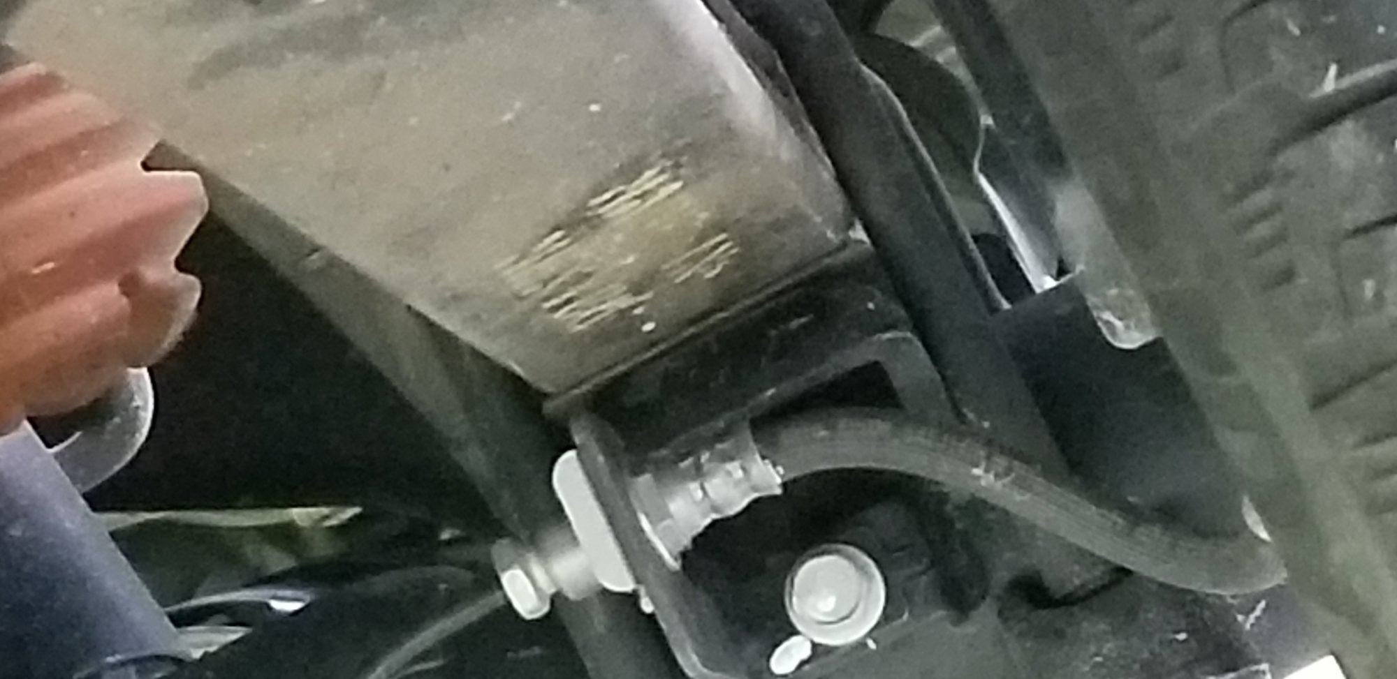

I do not see a block from factory. Here is a picture of leaf springs and the sag in the truck.

Ha, this is one of the only ones I haven't seen have a Block from the Factory. Maybe it's a Package you got or something, that keeps it out.
