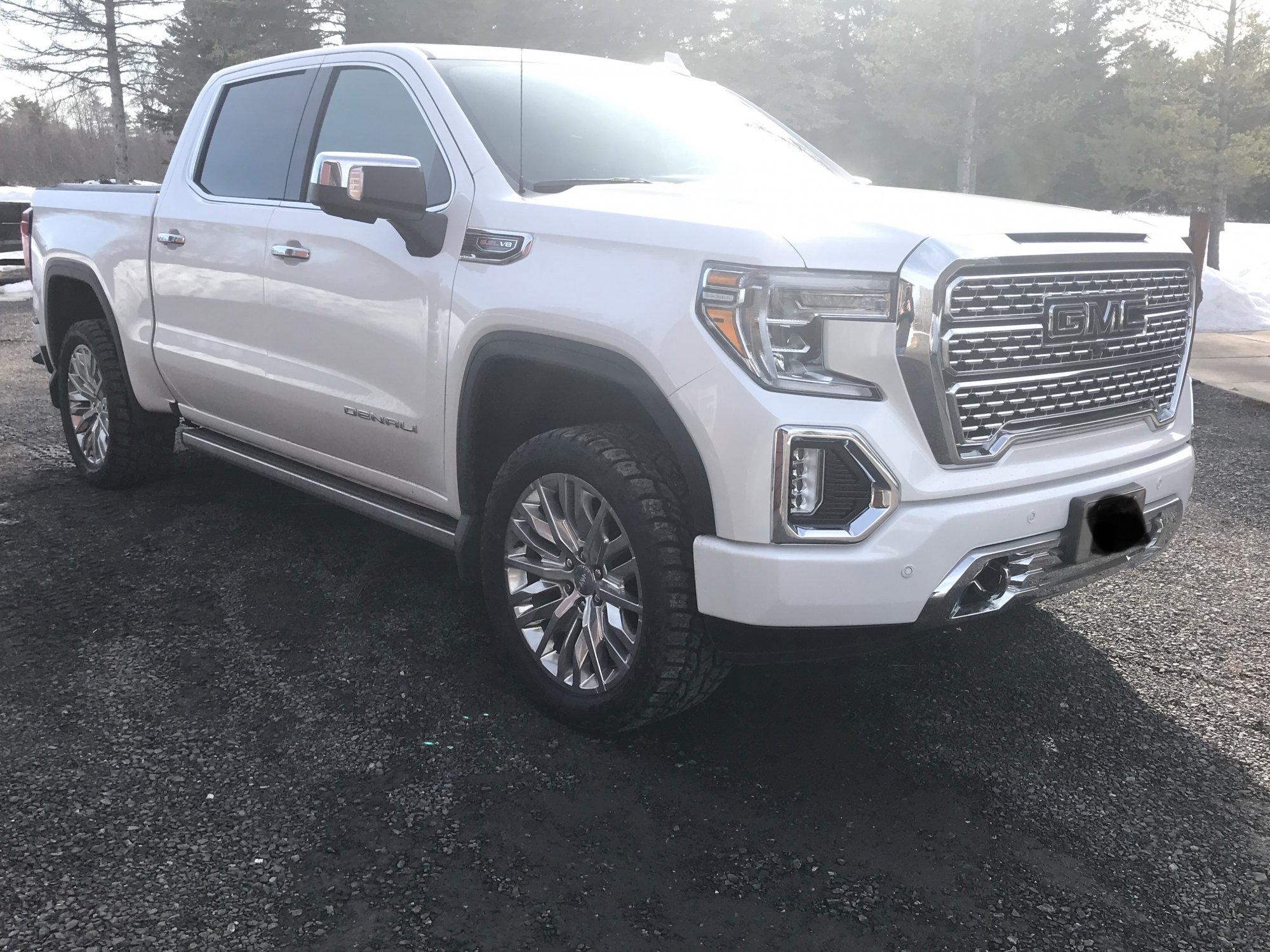

Sure did. Here’s a picture. Love this setup 2” level up front 1-1/4” block in the rear. 33x12.5x22 on stock rims. Had this setup for about 9 months and have never rubbed once. No trimming at all. Also added the performance exhaust this fall.
Looks good. I’m doing the same this week. I still have my rear block from my last truck also. I haven’t decided about exhaust yet. I am enjoying the quiet smooth ride. My last truck I was going to leave stock and within a month I had lifted with new tires, exhaust, intake, tune and bed cover.

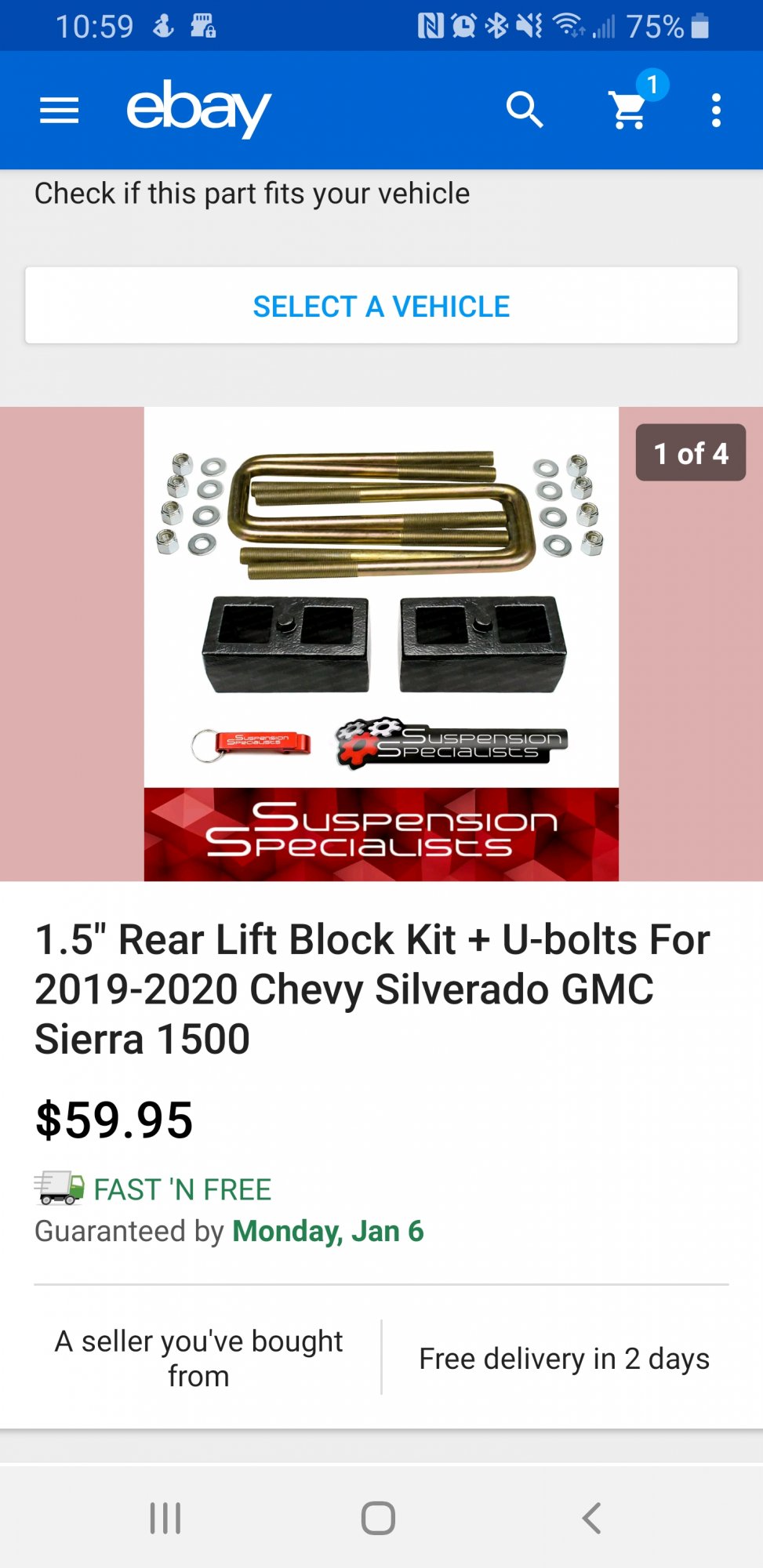

I have a 2" up front ant 1.5 rear.   I got it on ebay with the u bolts.  Easy to install. Also added the 2" rear shock extensions.  They were motofab.  Sits on 33" BFGs
Considering this for my 2019. Were these blocks flat? does your truck have the small factory shims, if so did you leave them on or take them off, any noticeable vibrations?
Thanks
Thanks
Honestly I didn't do anything special.  I just bought the kit and slapped it on.  I believe they were flat.  And I don't recall any factory shims when I did it.  No vibration at all. Truck rides very smooth. Maybe a little rougher shock absorption on rear end over speed bumps.  But I've also added air bags and that makes it stiffer too
